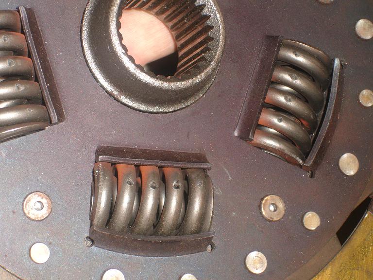

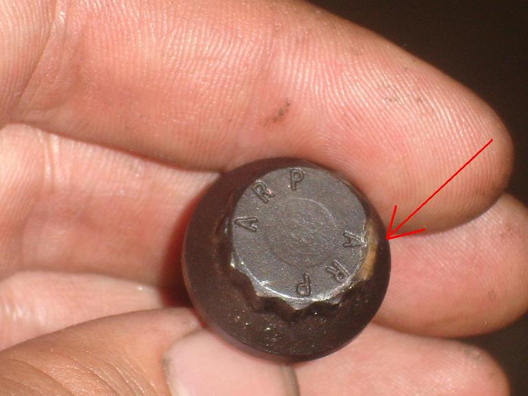

So I added a shim...no go. At this point I was going to put the centerforce flywheel back in, so I remove the bellhousing, pressure plate and flywheel.
Through the removal I noticed that the ARP flywheel bolts were rubbing the springs on the clutch disk. I then put both the Centerforce and the Fidanza flywheels side by side on my bench and tested them with the ARP bolts. No matter which flywheel I mate the clutch up to, the ARP bolts were too tall. To my local $tealer I go tomorrow

Bought new hardware from my local dealer today, and installed tonight. The difference between GM bolts and ARP bolts are just a few mm....but it makes a world of difference.
We didn't get everything put back together (removing driveshaft on my car requires that the diff and rear subframe be dropped down), but I did get to a point where I could verify that the clutch was disengaging by turning the driveshaft by hand.
Whereas before I could barely turn the driveshaft with the car in gear and someone depressing the pedal. Tonight with everything reinstalled using GM flywheel bolts the driveshaft rotated like butter!
