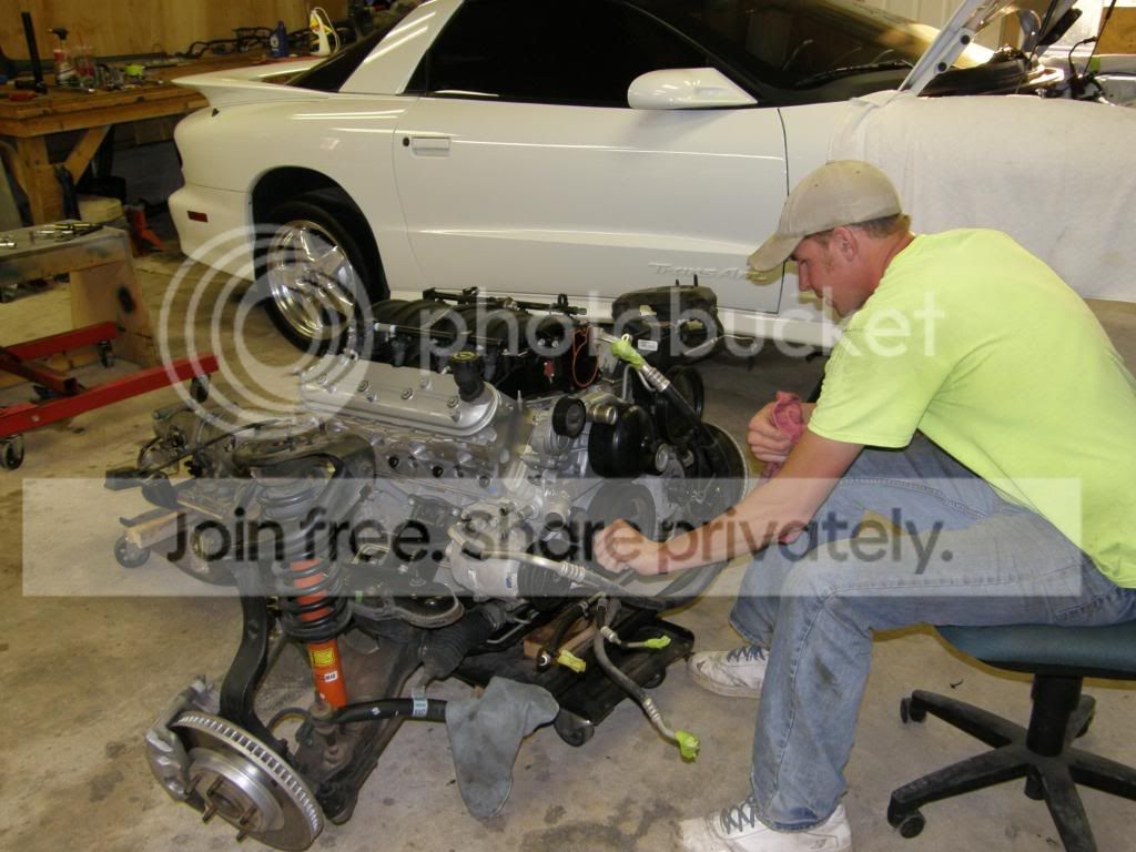

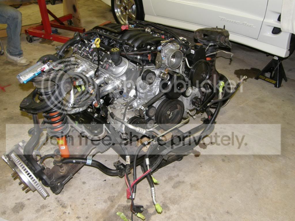

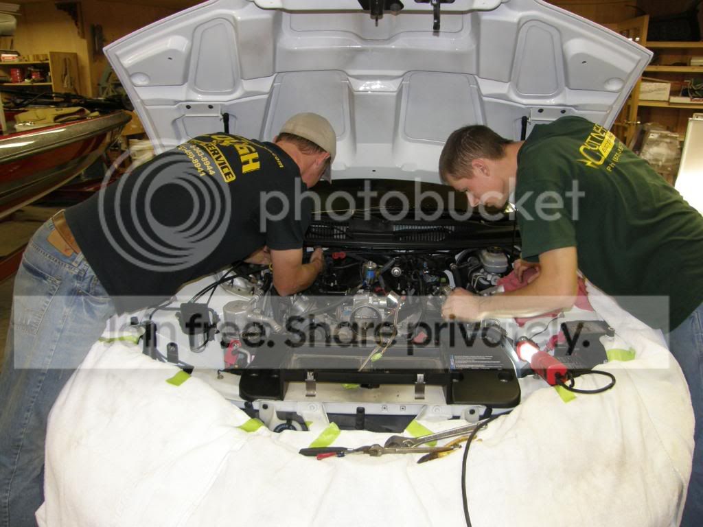

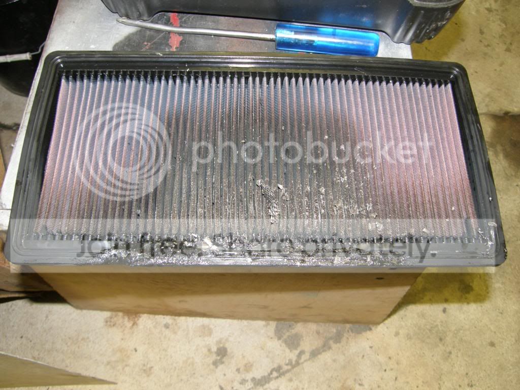

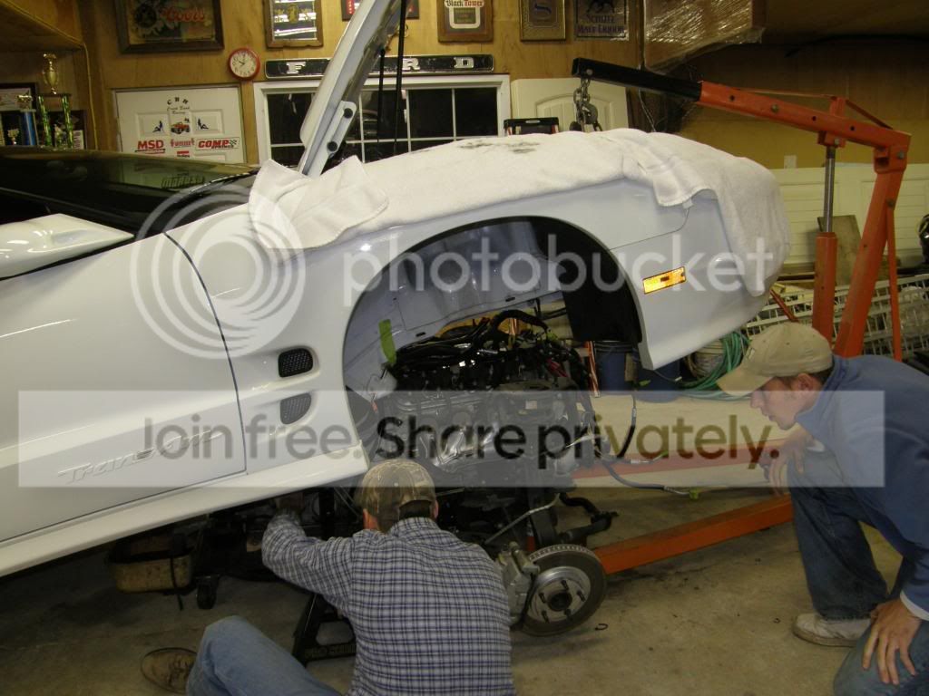

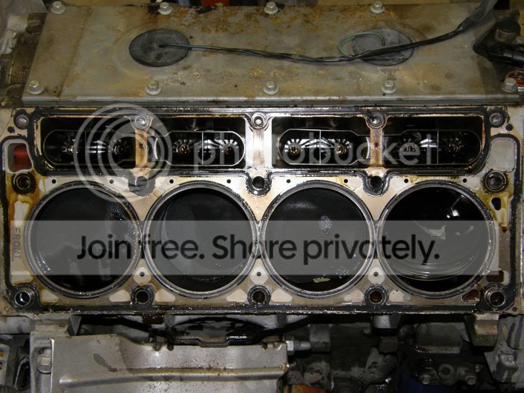

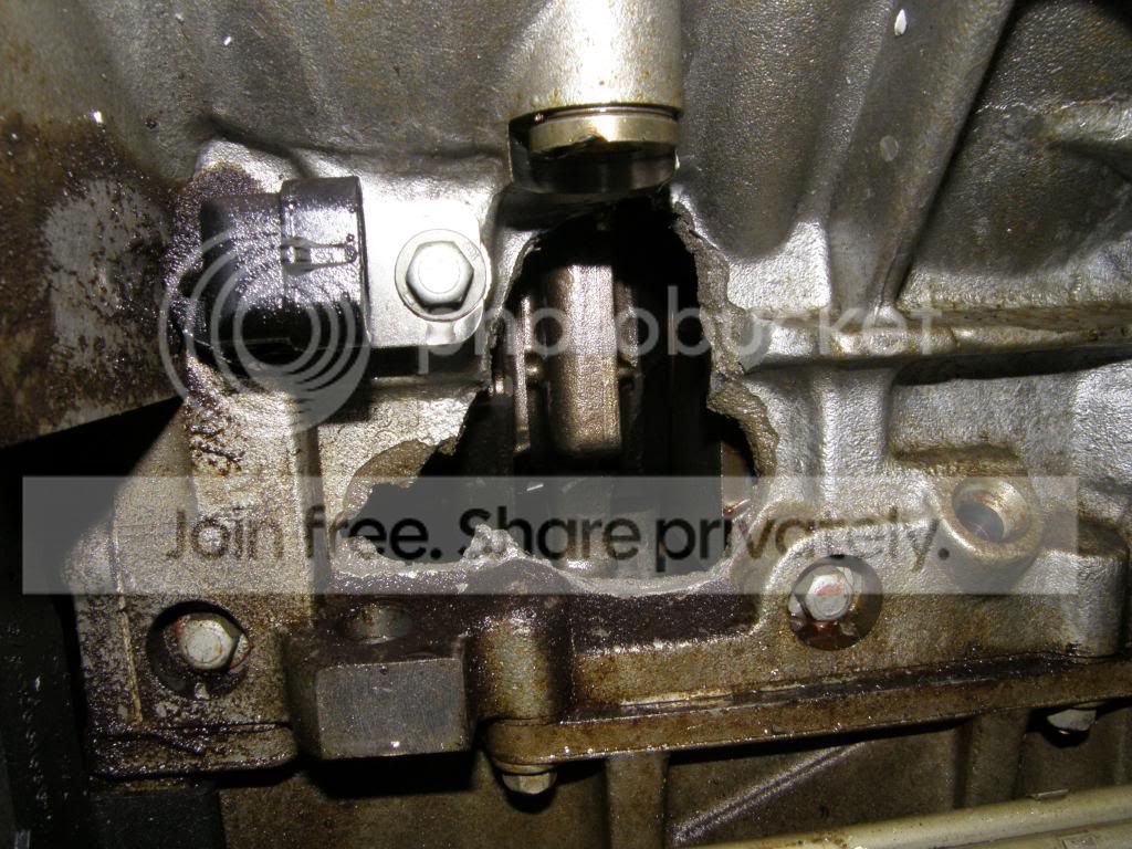

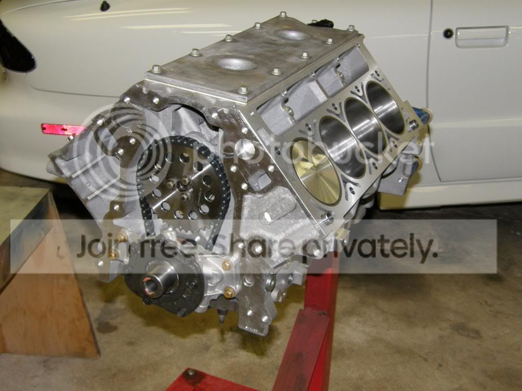

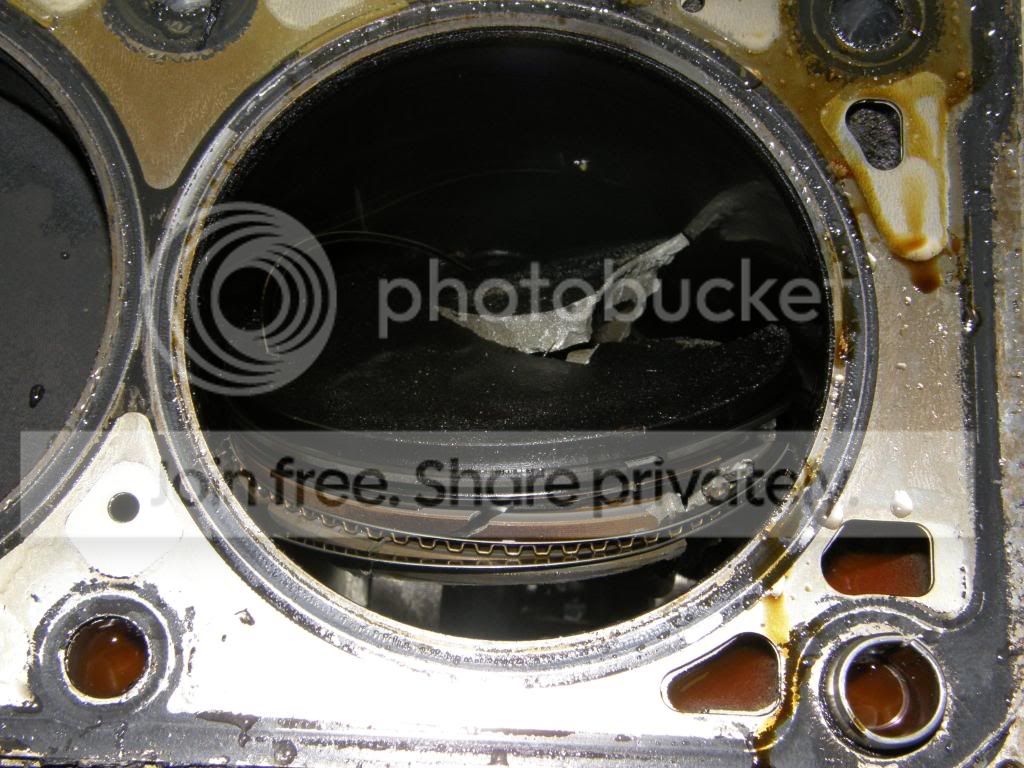

Well here is the story, i put a rod through the block on my 22k mile car back on December 7th at the same time it backfired and caught the airfilter on fire and almost burnt the car down. Its taken me a little while to come up with the money to do what i had planned, but it finally came together, i still have a few odds and ends to finish up, but they are minor.
I orderd a forged shortblock from SDPC and put in a MS3, ported heads, 3600 Edge stall converter, 42 lb injectors, and 150 shot going back in.

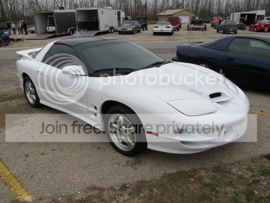

looks awesome! Wheres those videos?!

Is it the camera or that T/A is clean

Its the car, i keep it spotless.

so can you point out what was wrong with the original motor, i cant seem to find the problem lol
Old Apr 14, 2009 | 10:09 PM
99TransAm666's Avatar
Joined: Aug 2005
Posts: 116
From: Miami FL
I was gonna say the same thing man. Was wrong with it? LMAO

Was it tuned when you blew it up?

What did that short block runn you? If you dont mind me asking
Old Apr 15, 2009 | 10:21 PM
Cape T/A's Avatar
Joined: Mar 2008
Posts: 1,034
From: Cape Girardeau, Missouri
Short block was about 2900 shipped.
No tune was on the car, i had a 125 shot on it. I ran the car all year without problems, i personaly dont think nitrous was the direct cause of the failure.

why is it always that cylinder to go? every time i hear of a rod going through the block, its always from that cylinder
i think its from the pcv system that lets oil build up and just lay in the intake, and under heavy acceleration it goes to the back of the intake and some of the oil goes through the runners and then the piston compresses oil and its done for. Just my guess, at least thats what i think caused my failure.
