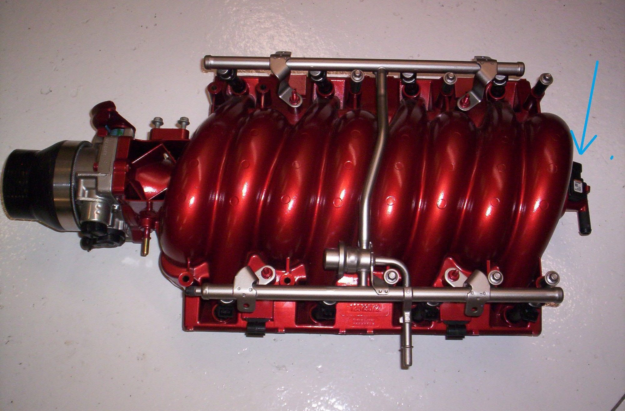

I have a LS1 engine in a '02 Trans Am. I'm trying to find information on how to correctly install the MAP sensor. Any help is appreciated.

It's on the back of the intake manifold. Reach around the back unplug the harness and start to pull and wiggle upward, it will come right out. Be some what gentle not to brake the little lock tab on the intake manifold, you can push slightly on the tap to flex it out of the way. Here's the MAP...

^^What he said, I've done it my self it's hard to reach but it can be done. I had to do it myself 2 years ago, I think I reached it from the passenger side, and be careful not to cut yourself there are some sharp scews or bolts coming down from the cowl and you really have to jam your arm in there.
