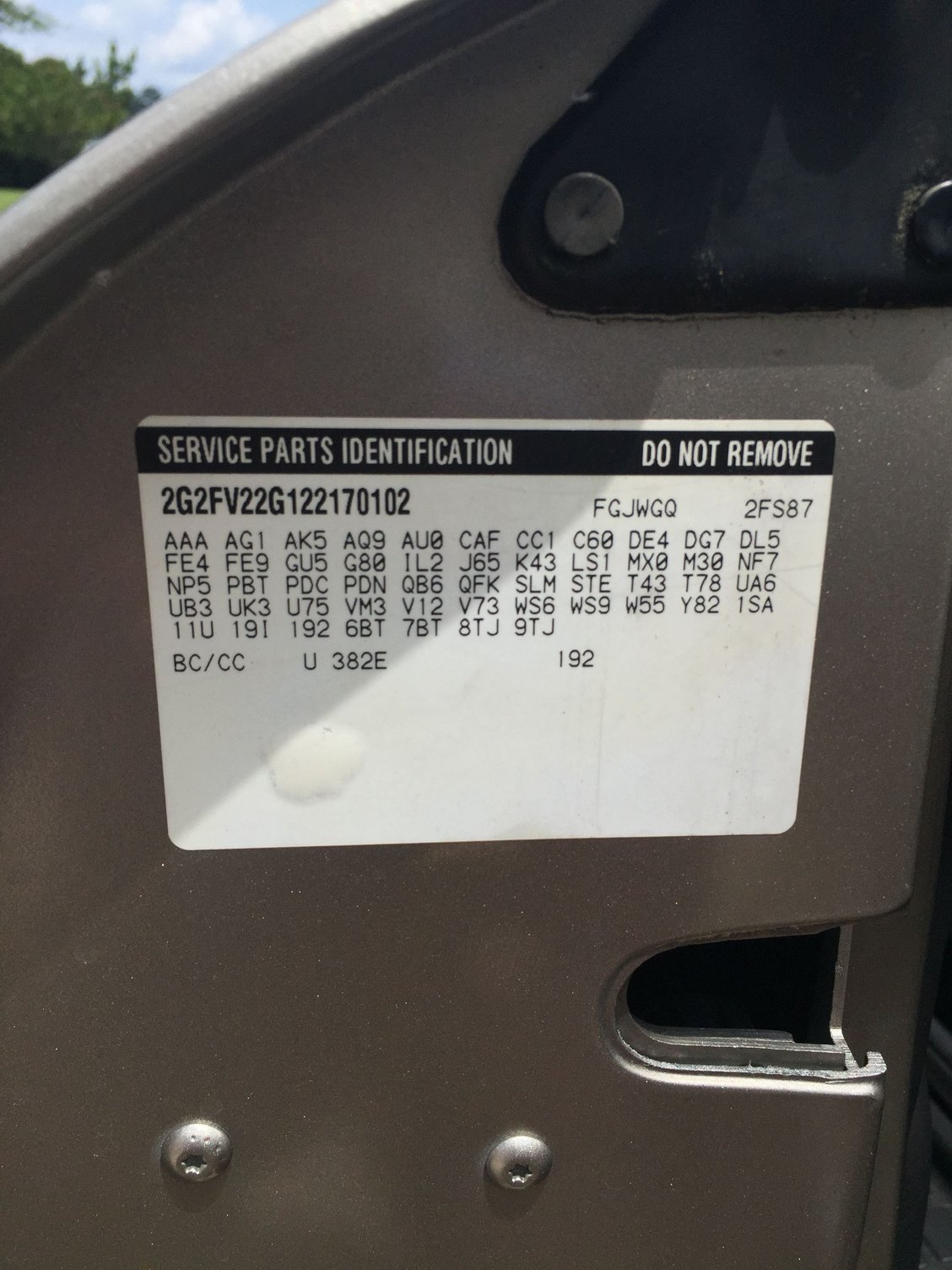

Thanks for that bud i think it'll be easier just to post my codes, the only other P code I have is PDC for the theft system. If you have the time could you shoot me your list or tell me what ones I have?
I don't have PDC in any of my lists, but your "Theft Deterrent Alarm System" code is actually UA6.
In this case your primary wheel code is not part of the "P**" series, it's QB6 which is more commonly known as "Speedlines" for the '01 and non-CETA '02 WS6 cars. Tire code is the same for all 17" wheel equipped LS1 4th gens - QFK (275/40/17 BW, in this case Goodyear Eagle F1 GS.)
Unfortunately I can't send you my lists as all my data is either by memory or, when that fails me, shop manuals and old paper copies made when these cars were new (and I don't have any of them scanned...maybe one day.)
Are there any other specific codes you're interested in from your SPID that you don't already know?
