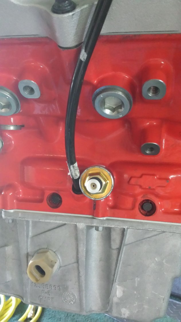

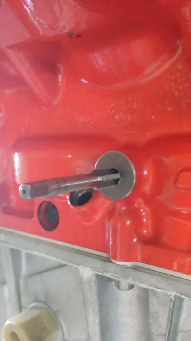

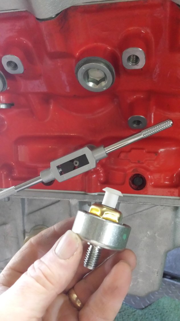

Yes you can find areas on both sides of a Gen 3 block to drill and tap for knock sensors. The intake manifold is not that difficult to remove and most likely there's a faulty sensor or connection issue with the sensor or sensor harness or both. Not uncommon to find the rear knock sensor rusted to the point of a bad connection due to moisture finding its way done into the valley cover hole for the knock sensor. I'd make sure to use quality parts and seal the grommets on the knock sensor harness to the valley cover to prevent moisture from getting in there.

Understand.
Thanks for the response and the pics!!
