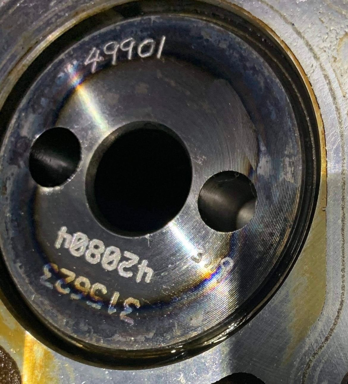

I’m trying to find out what the cam spec on this cam is. It’s out of an LS1. The guy who installed it reckons it’s a comp cam 231/251 but the numbers on the back are very random and have asked around but no one seems to know what they are. Does anyone know someone I could get in contact with to see what it actually is. I’ve been stuffed around from this guy on the same car so I want to find out if it is what he says it is without pulling the engine apart to calibrate it manually.
the numbers are as shown on the cam
315623
420804
there is a 49901 which has been hand engraved on the opposite side of those other numbers

Hi... Did you find the brand of cam... I Have one in my LS3 Wagon with similar numbers.315623 419800 engraved is 49919 and looks like 8.17

I think these might be the specs. I’m not sure who the vendor is.
I think I found it on page 10.
https://camshaftmachine.com/wp-conte...2015-01-30.pdf
