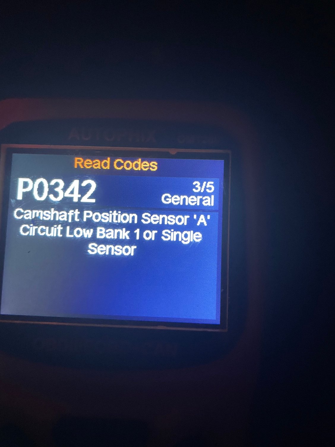

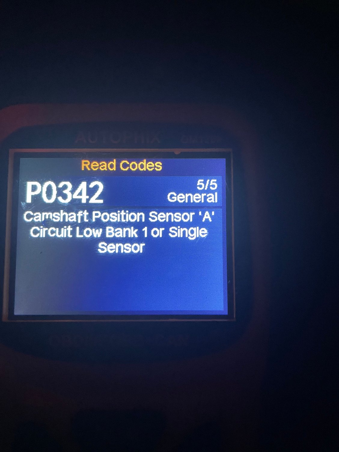

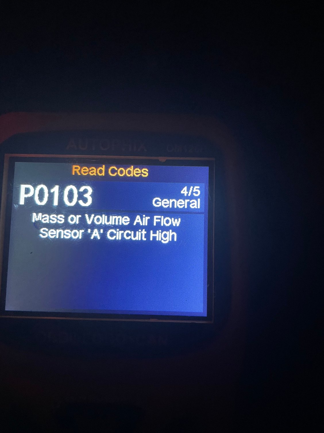

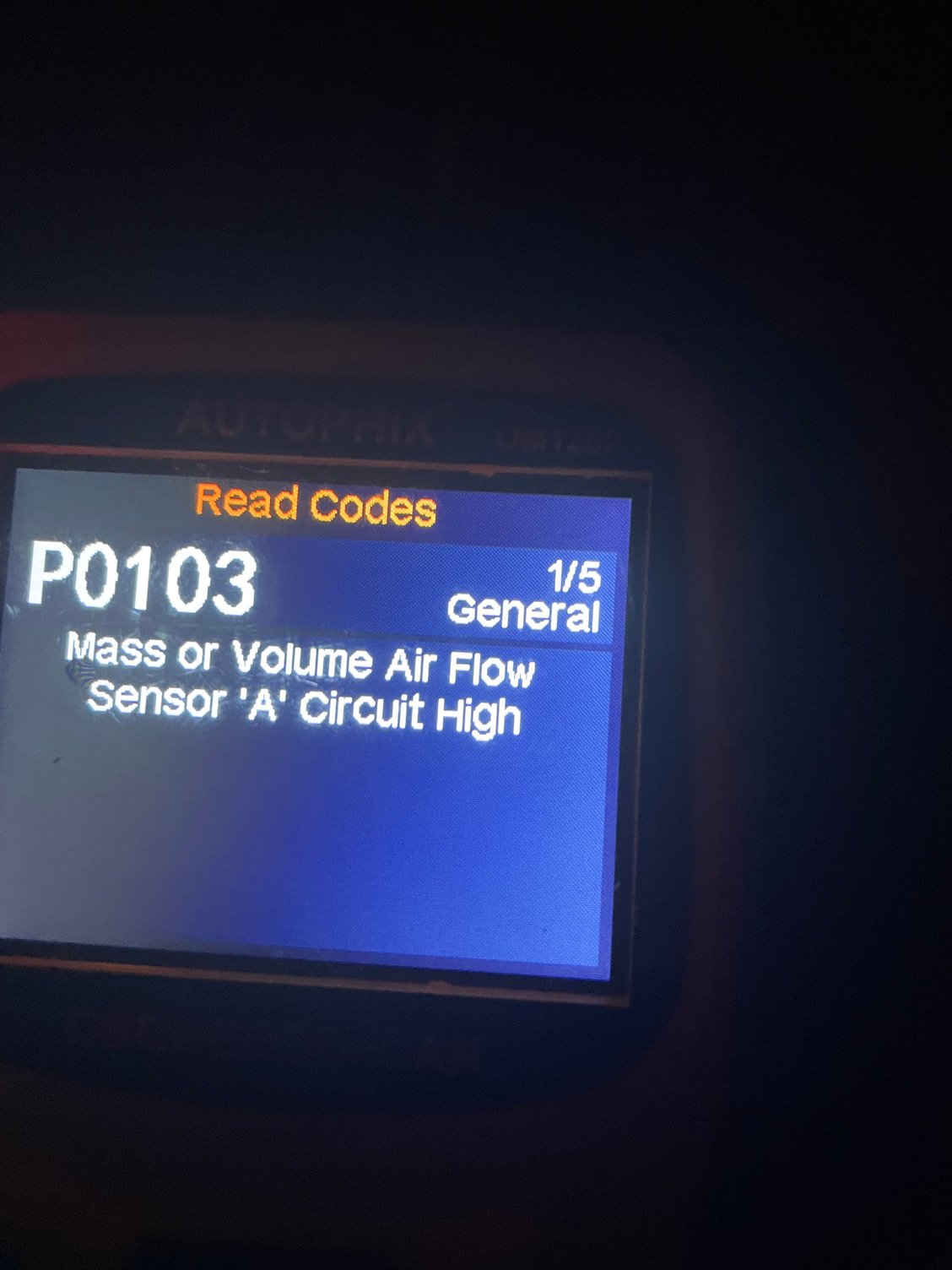

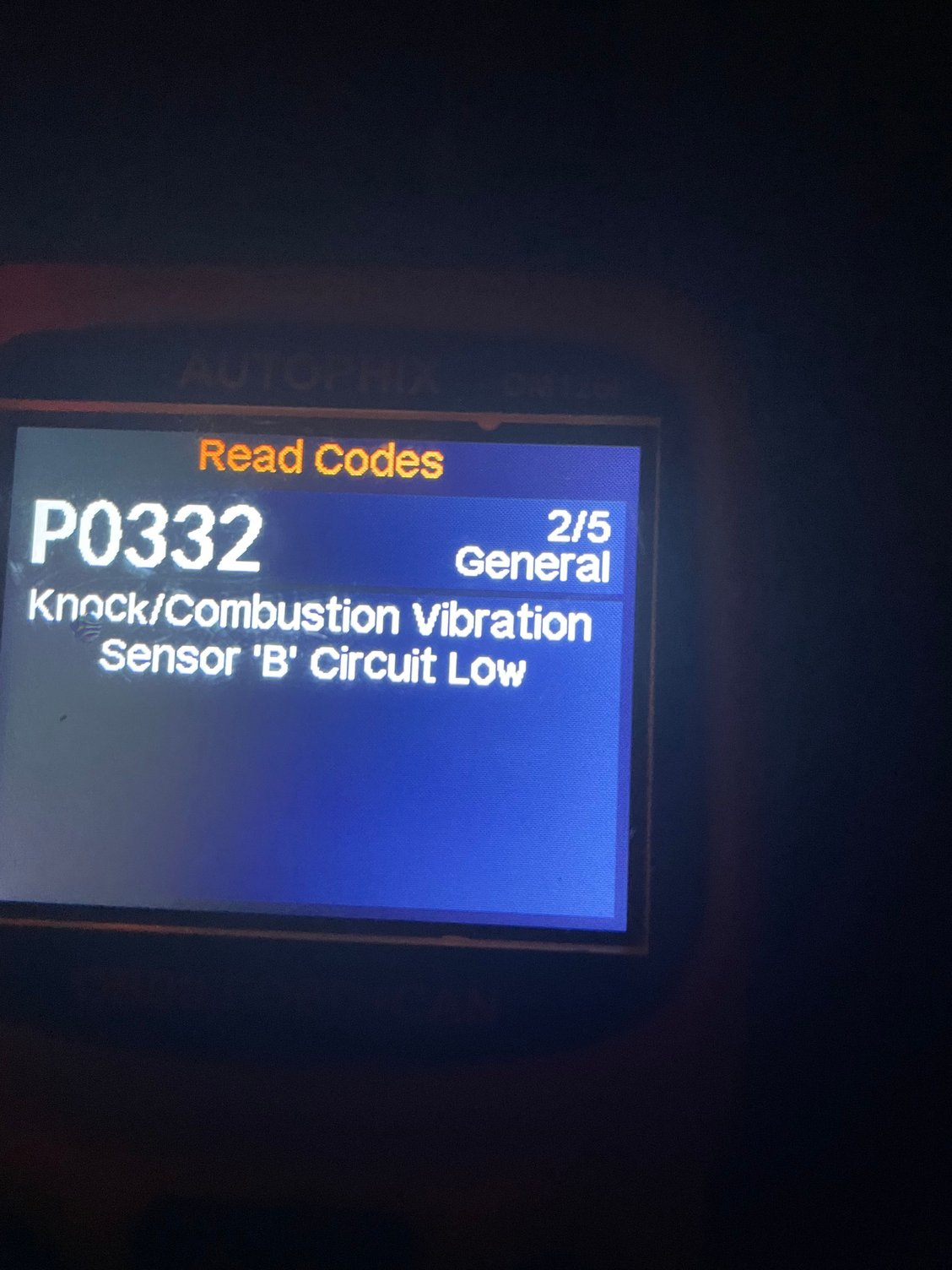

I have a 94 camaro with a Turbocharged LS swap. It has the wiring and ECU out of a 98. I just changed the starter/battery/thermostat and added nicks power steering pump mod. After reinstall the engine oil low came on, I shut it down, check the oil (good). I restarted light went off but the check engine light came on and the car is now running extremely rough. It had 5 codes pictures attached.

Were all the Batt+ and ground wires reattached after the work was completed? Check the wiring. If it was running good before your work, there probably is a power or ground wire that was not reconnected, or it is not making good contact now.
