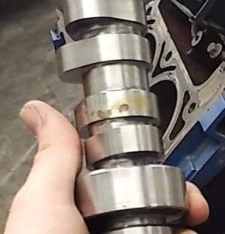

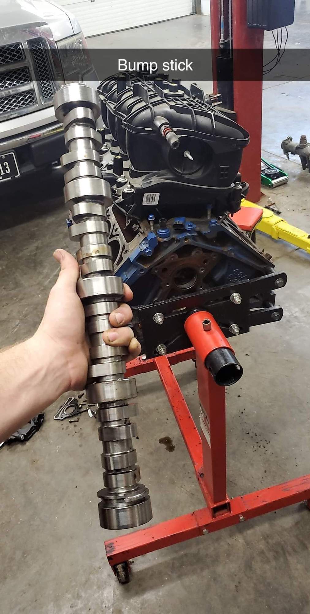

Would this cam cause any problems for me? I was thinking of polishing up with some wd40 or pb blaster and 0000 steel wool. Thoughts?

Is that a pit in the second picture or just a stain? If it is a pit that I could feel with my finger then that cam would be a no-go.

Polish it and then feel for imperfections. If you don't feel any run it. Stains won't hurt
