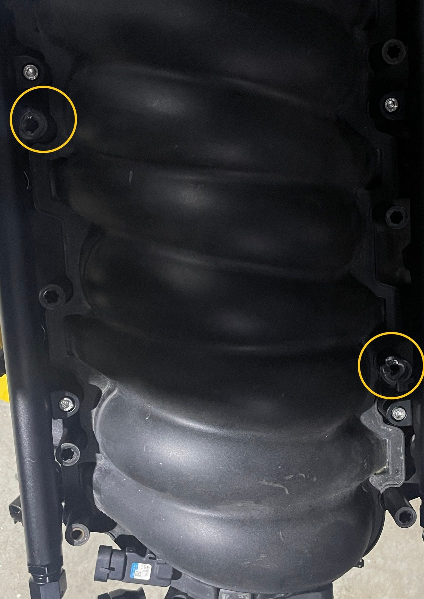

Help me please, overtorqued my LS2 intake manifold what can i do? Threads are still fine
can i fix this? Or get it fixed

You could get regular hex head bolts of the correct length and flat washers instead of the socket head bolts. My LS3 is like that. I use SS bolts and washers. Keep in mind the bolts are metric. I got mine from Fastenal.

do you mind sending me a few pictures? So you got rid of all of the grooves for the bolts?
