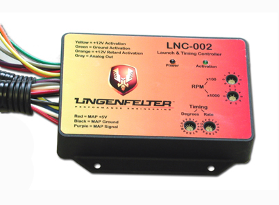

Default Nitrous timing retard
Our LNC-002 is designed to provide timing retard (along with a 2-step function). You wire the timing retard activation wire to the nitrous activation/solenoid. You can adjust the amount of timing retard and the rate at which the timing is removed.
The LNC-002 plugs into the factory GM coil packs connectors.
For more details, you can go to the installation instructions here.

Old Jan 11, 2009 | 07:46 AM
Robin L's Avatar
LS1Tech Sponsor
Joined: Feb 2006
Posts: 1,170
From: Rockfield Kentucky
One box....I stand corrected!
Very nice Jason.
Robin
