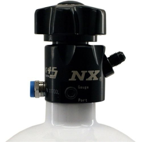

Op. Did you manage to find the NX valve with a push port for the 15 lb bottle? If so can you share the part number for the 15 lb valve and where you get it from.
Our First gen version of the Lightning 45 valve has a push port for use with the Nano stuff. Other than that our old white handle 45* valve also has a provision for the Nano via push port.
Lightning 45*
Only the very first run of these valves had the push port. After the first initial run we changed the design to no push port.
Old 45* Valve
-Chris
