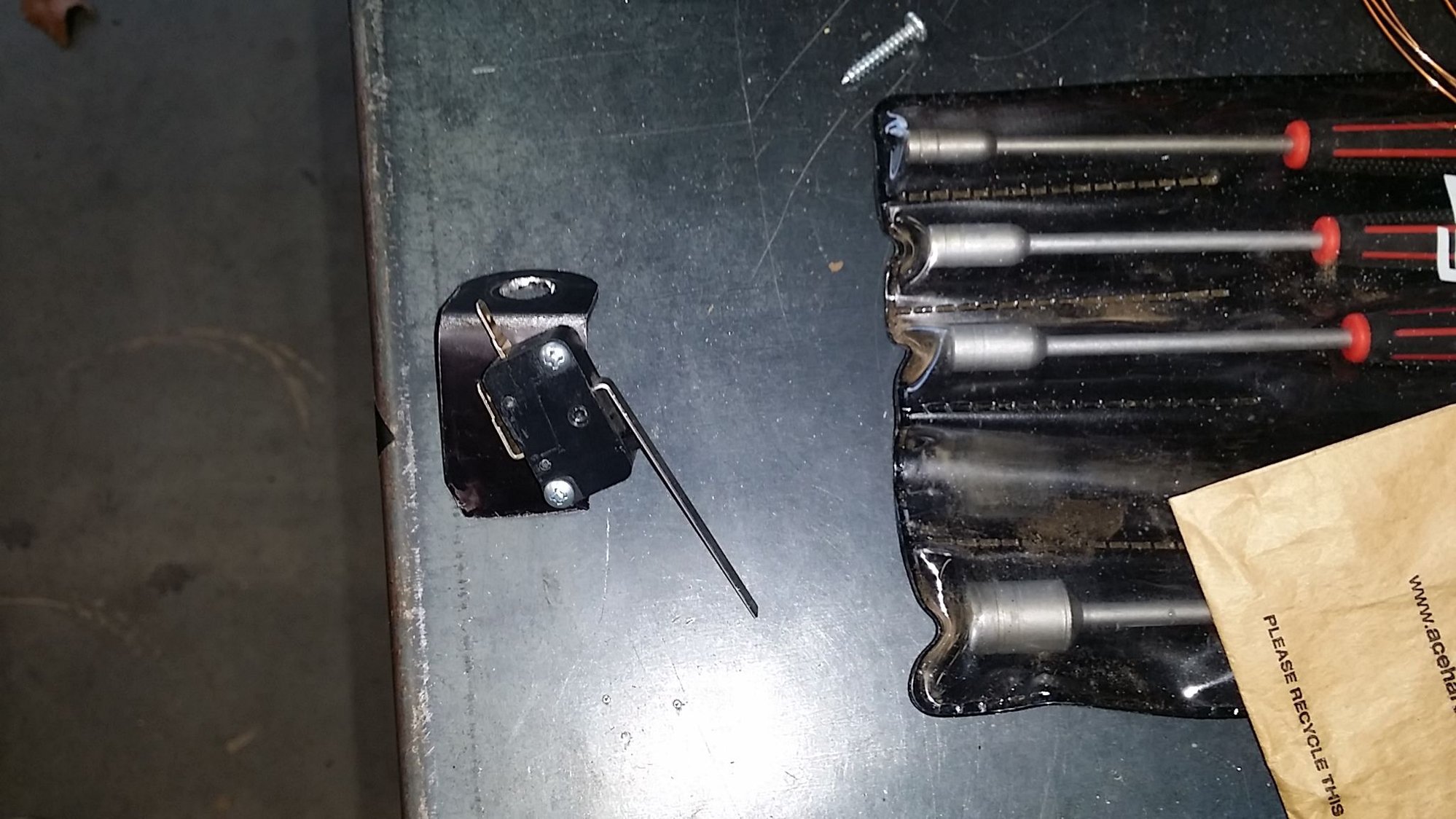

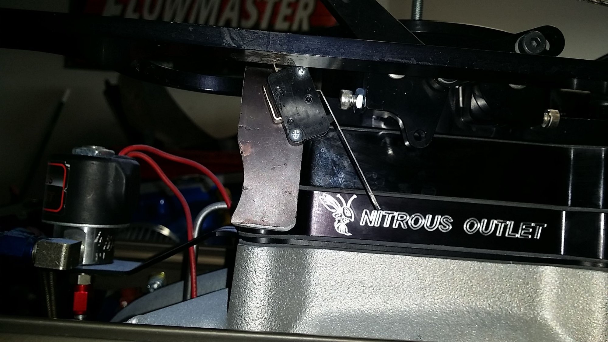

Does anyone have any pictures on how they mounted the n20 wot switch on the accufab 4150? Trying to get a few ideas on this. Thanks

I don't have any pictures because my car is at the paint shop right now. I made a simple L bracket to attach the WOT switch to and bolted the bracket to the front bolt that holds the throttle body to the intake. At WOT the heel of the T/b linkage just touches the switch.

Here are the picture of the bracket and switch. Just a simple L bracket, angled the micro switch so at WOT the heel of the linkage touches the switch.
After I trimmed the excess length of the bracket
