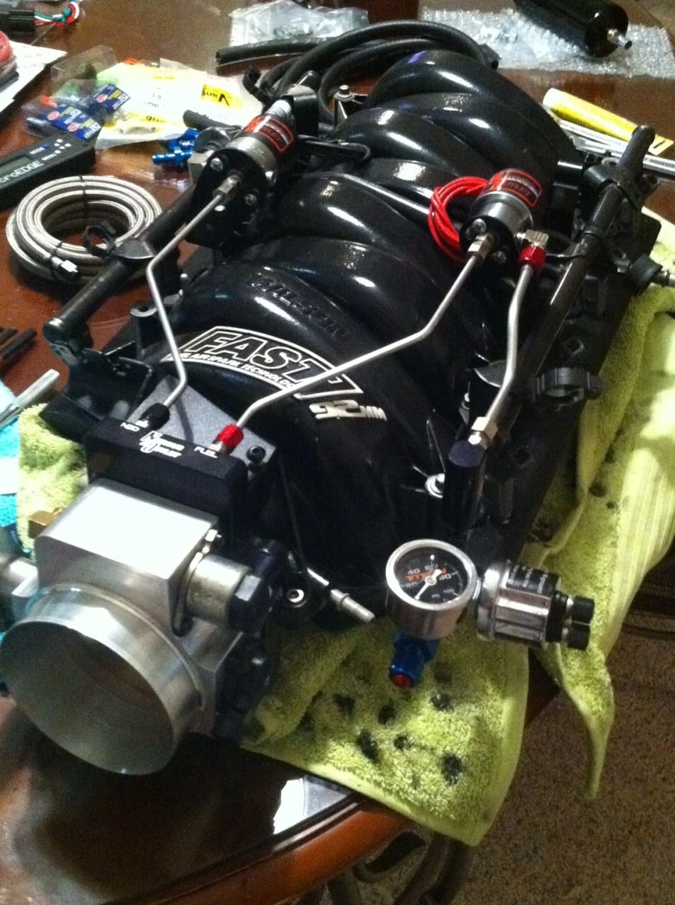

Nitrous Outlet 92mm plate kit (jetted at 52/23 for now, may adjust today)
HSW Microedge (window switch, TPS switch, A/F cutoff, etc)

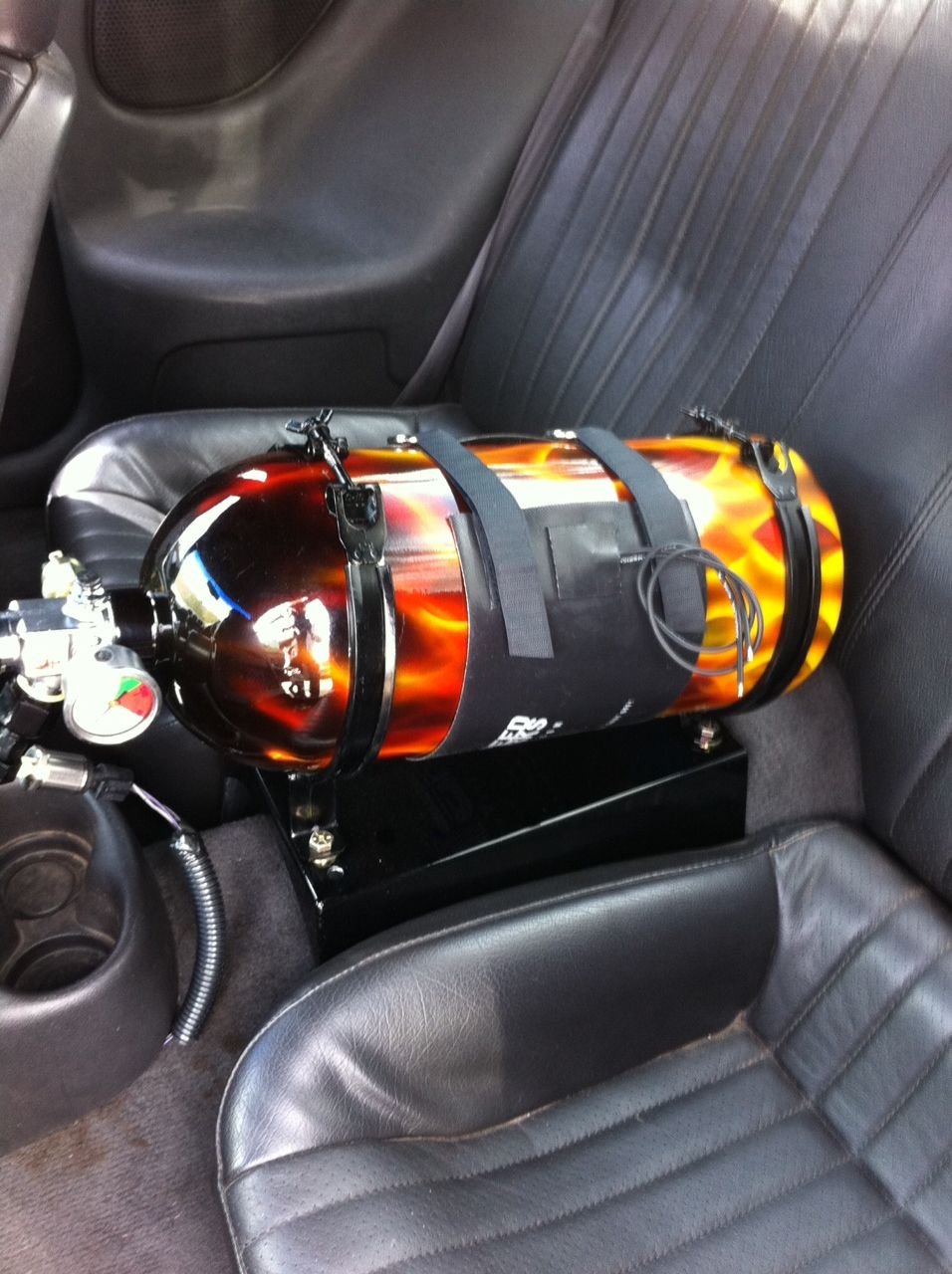

HSW bottle heater
Lingenfelter LNC-2000 to pull timing (pulling 5 degrees for first pull, may adjust this as well)
BR7EF's gapped at .035

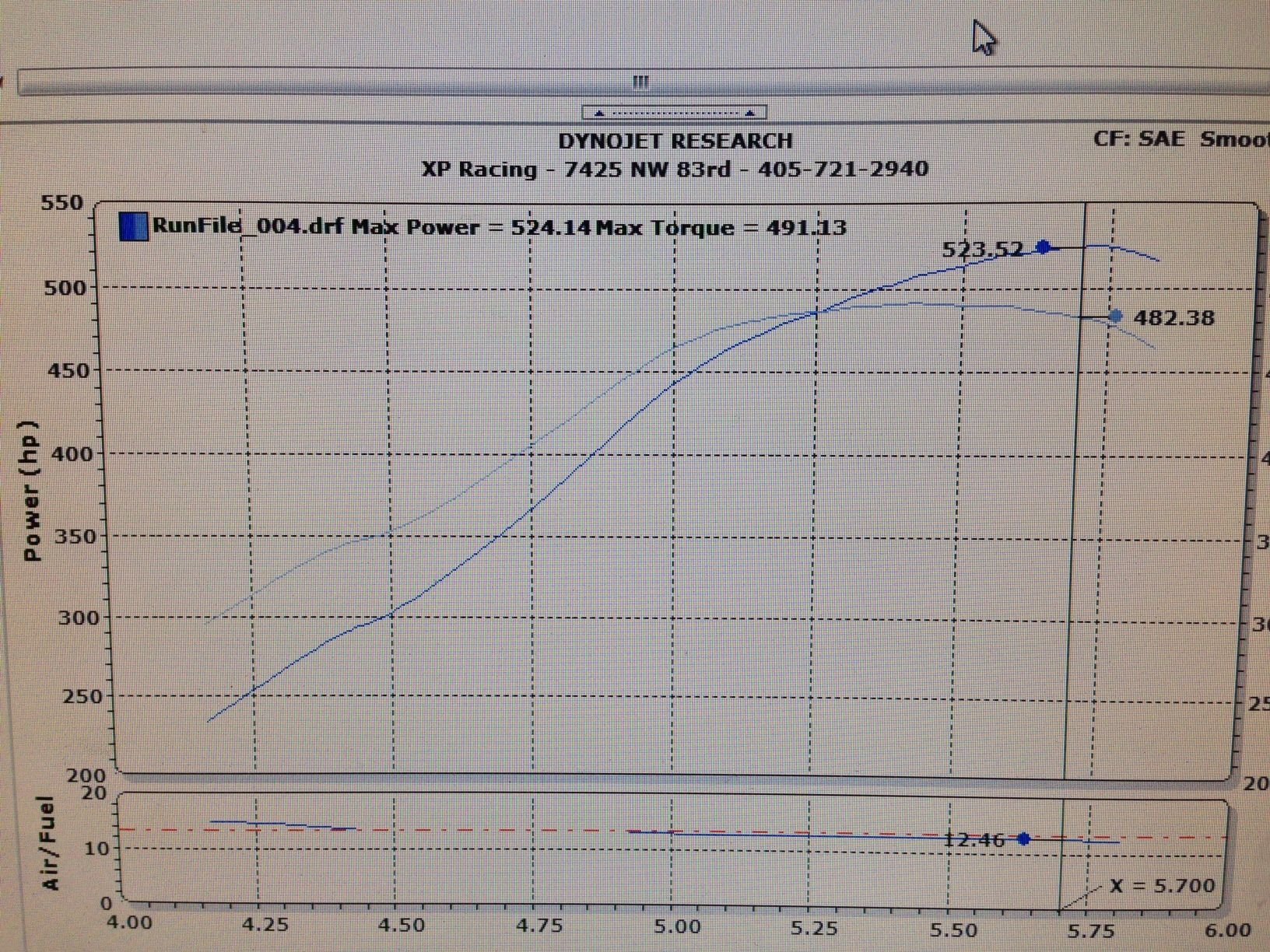

Made 401rwhp unlocked (changed tires/wheels), 525rwhp unlocked on a 100 shot!
Took it out last night and made probably 6 passes, feels like completely new car!
This is on 6 degrees pulled since I'm running 91 pump has, also 12.5 a/f (this was at the tailpipe, my idea and at the collector shows 11.8 A/F).
