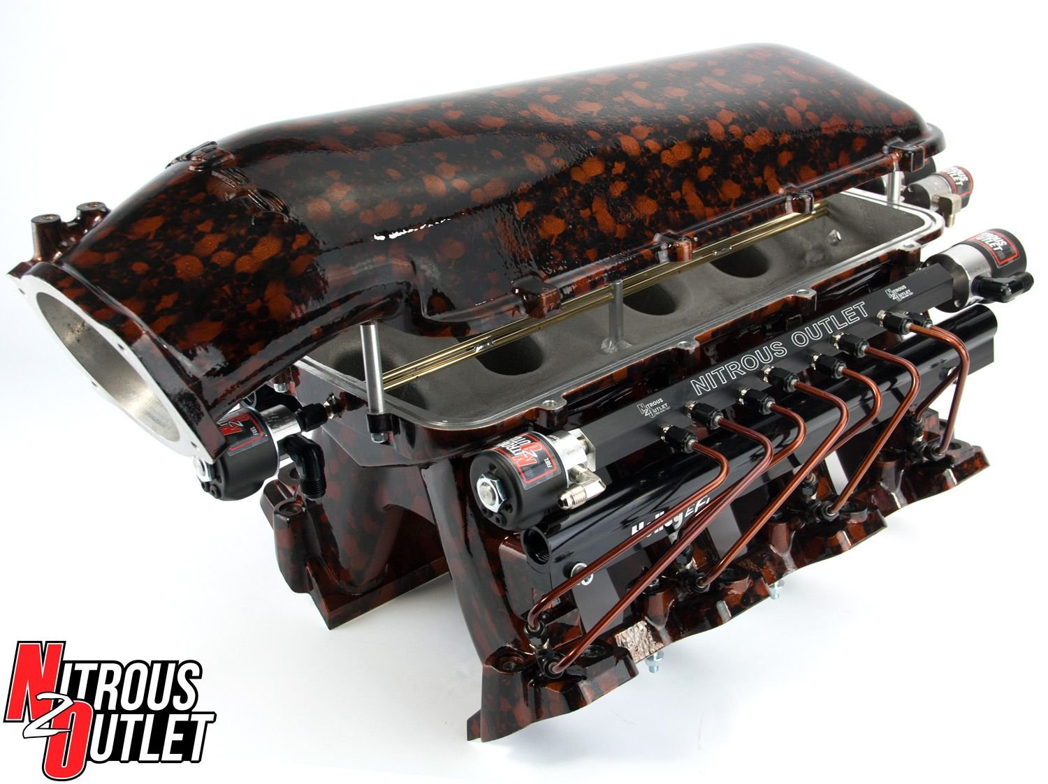

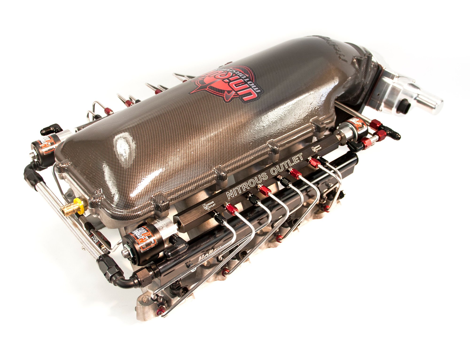

Here's a couple that we did..the bronze colored intake is setup with 2 stages (direct port with a spray bar) and is currently for sale.

I think the spray bar would be a good way to go to minimize the amount of parts required. But would be a lot easier to to setup for a fogger setup just in case I can't fit my p1. I'm wanting to have the coated or dipped soon while I continue on my build

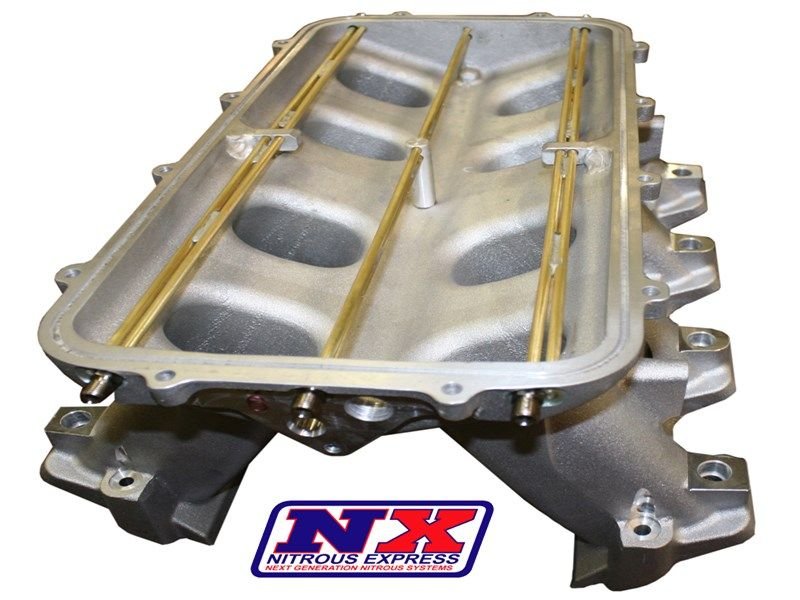

Spray bars is another great option, especially with something thats already making a good amount of power with the supercharger. You will see a huge drop in IAT's as well as a good gain in hp/torque. Even on a 75hp shot, you should see well over 100 ft/lb's gain.
