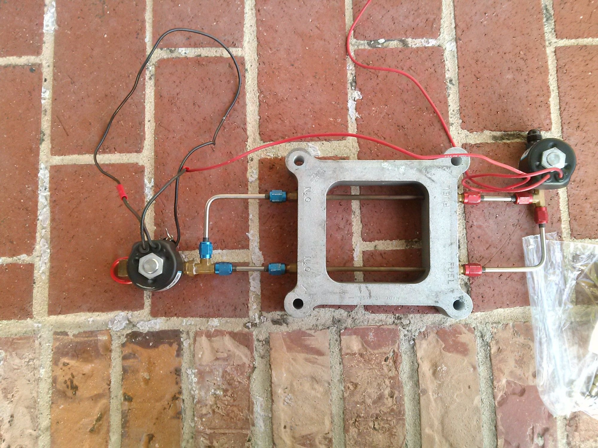

this is a older style plate twin bars plate would any of you still trust it or would you just upgrade when money free's up a little.it was my carbed 6.0

R they the most competitive plate. Nope but for a 150 or less I'm sure it will be just fine. Got a buddy with a sbf that runs those 2 bar plates and it picks up great on a 200 hit. But I'm sure if ur looking for every advantage then a stinger plate or something alone those lines would be best

Make sure none of the bars are twisted or loose, and that air blows out of every hole. Other than that, you should be fine. Nothing wrong with our older stuff!

thanks...i was spraying 150 and it picked up real good and now i have a forged bottom end so now im wanting to spray 250 to 300 with any problems.

Gotcha. If you are going to be spraying 250+ regularly you might look towards getting a direct port! (We can get you set up when the time comes.)
