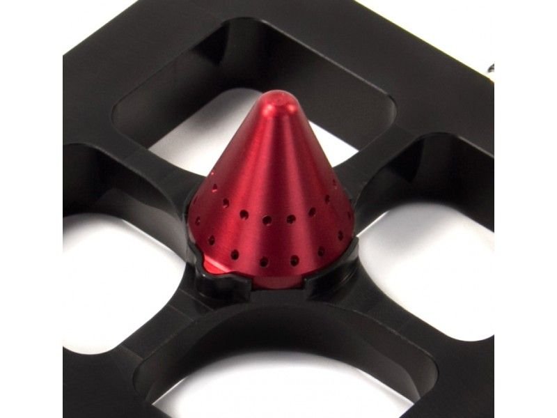

With one of these:
Old Jul 2, 2015 | 05:02 PM
slowlsx's Avatar
iTrader: (28)
Joined: Sep 2008
Posts: 2,258
From: Deer park
That's the plan!! How thick is the hornet plate?
Originally Posted by brandon@nitrousoutlet
Agreed!
With one of these:
Old Jul 3, 2015 | 09:28 AM
brandon@nitrousoutlet's Avatar
FormerVendor
Joined: Feb 2013
Posts: 1,479
Likes: 21
From: Waco, TX
They are 5/8" thick. Not counting the stinger itself.
