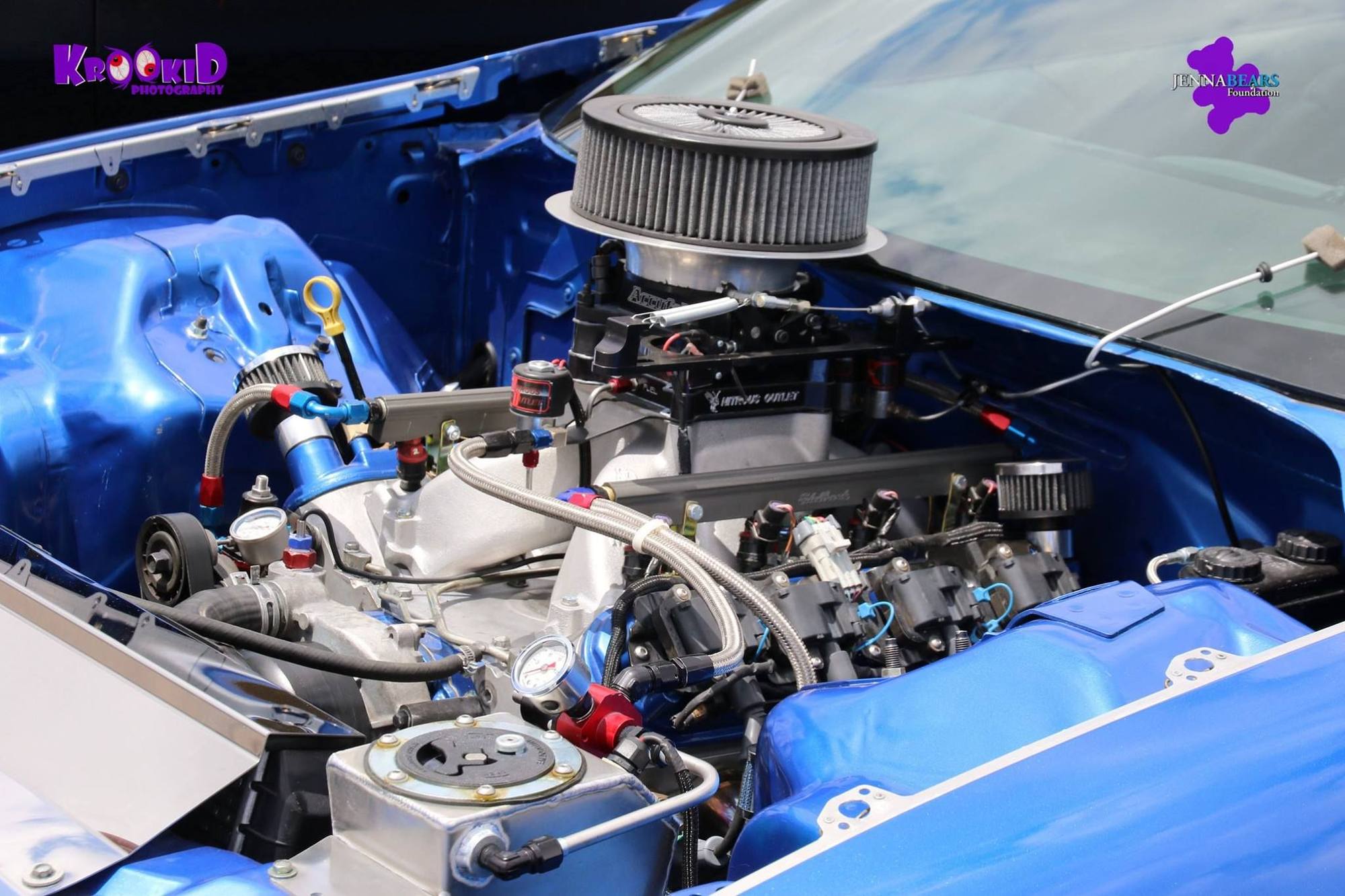

I have center drop on mine, but it's efi with 4150 throttle body and 1" spacer. With 1" spacer the carb should clear, if not you can flip the solenoids so they are upside down it should clear carb bowls without a problem.

Nice setup RobsZ28!
