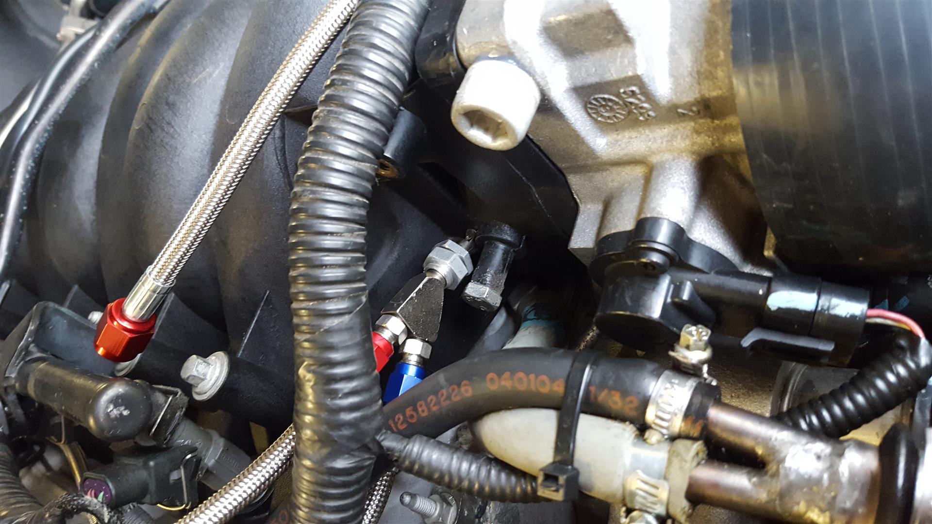

Bought a LS1 wet kit to install in my car, but where i can put the nozzle in?
I know about putting the best in the elbow or tubing from my CAI, but german law declared nitrous gas as a drug, so i have to hide it the best i can, especially the nozzle they will see, when opening the hood and there would be no time to go in prison or pay a lot on punishment at the moment!
So my question is, can i put the nozzle into my LS6 manifold behind the throttle body in the old oil steam inlet, which i have closed since my oil catch can is installed?!
Regards,
Ronald

I wouldn't put it there. to much risk of it not atomizing enough and could cause a nitrous backfire. If u need to really hide it and don't want to install into cai use a plate instead of a nozzle. if your running true sd and not a maf u can add the nozzle right behind the air filter on the bottom side to hide it. If your using a maf kit u can add a dry nozzle before the maf (nozzle into air filter) and let the maf add the extra fuel via injecotors. Your call!

Yes, this might be my solution, use a plate kit, who has one lying at home and can give me some measurements of the holes into the plate?
Thx!
