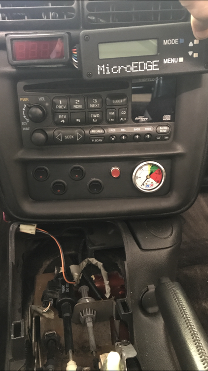

I have my supply line running through the console and tee'd a regular gauge in my switch panel.
