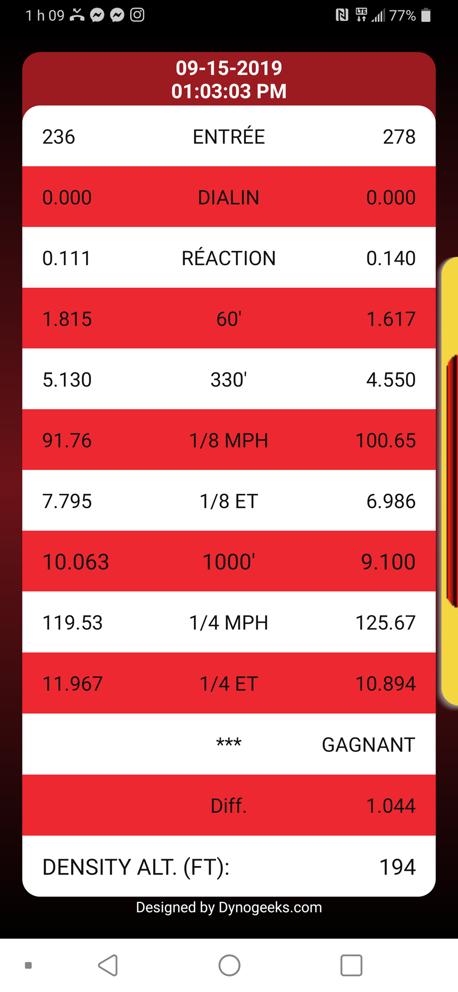

went good..!! but no good 60ft. greasy track. ...did a 10.8

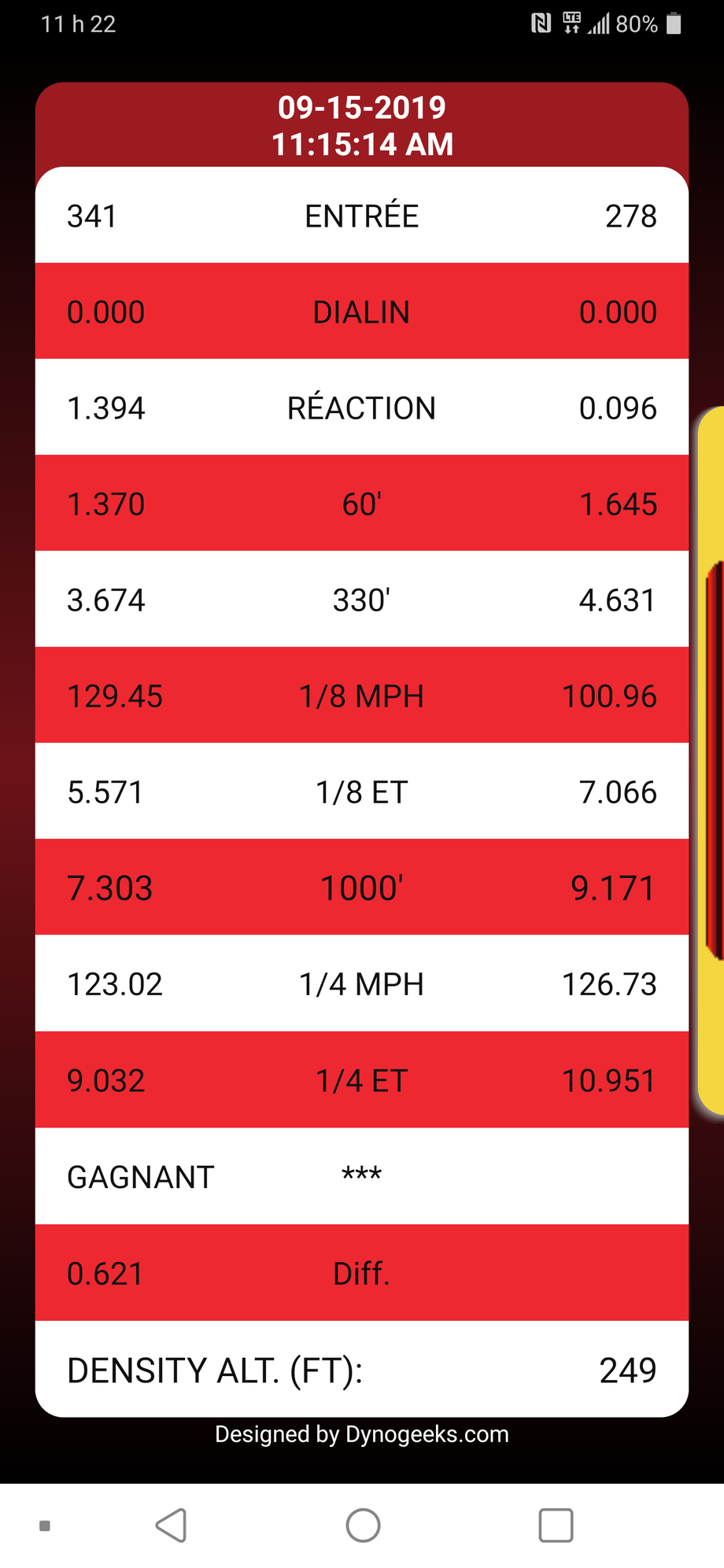

best trap 126.73

60' isn't horrible! Would love to see some plug pics if you have any. What nitrous/fuel ratio? And what is your air/fuel on motor vs the bottle? Definitely crazy that it is only wanting 3 out of it, but if that's what it wants, then that's what it wants!

usually im cutting 1.5 60ft ... the plugs are very nice...brownish color ..strap are all nice...i will post some pics. soon...running on 94 pump gas mixed with 109 oct unleaded race fuel...afr are 11.5 to 12.5 at wot..stock fuel pump ..bottle at 900psi using NX 73 and 42 jets

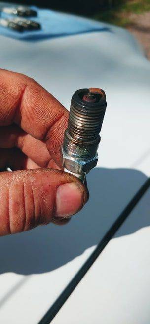

here s some pic of my plugs...they have 6 bottles on it --- 4 of 150 shot and 2 of 175 shot....and about a 1500 miles ... did a test with a new plug ..but dont have a pic.....putting some fresh one tomorrow

Get a pic of the new plug if you just made a single hit and pulled it. Can't tell anything from those. Looks like you got some oil in there too.

one thing i see is the strap are all there...and no detonation sign .. so..thats good for me .. and a did pull my plug wen they were new to see if all was ok after my pass

Lol those plug pictures are completely useless man lol. Gotta put a new plug in... do a pass.. coast to a stop... and pull the plug then. Check the timing mark on the strap and cut the threads off and read the fuel ring at the bottom of the porcelain. Only way you get any real information about how it’s running on the bottle.
Car is moving tho 🤙 .
Those plugs look like they are 5 years old tho 😂 and Like said above looks like there is oil in there. I’d get a little pcv catch can setup on it... helped on my truck (had new valve seals tho) What’s your wideband read during a pass?
