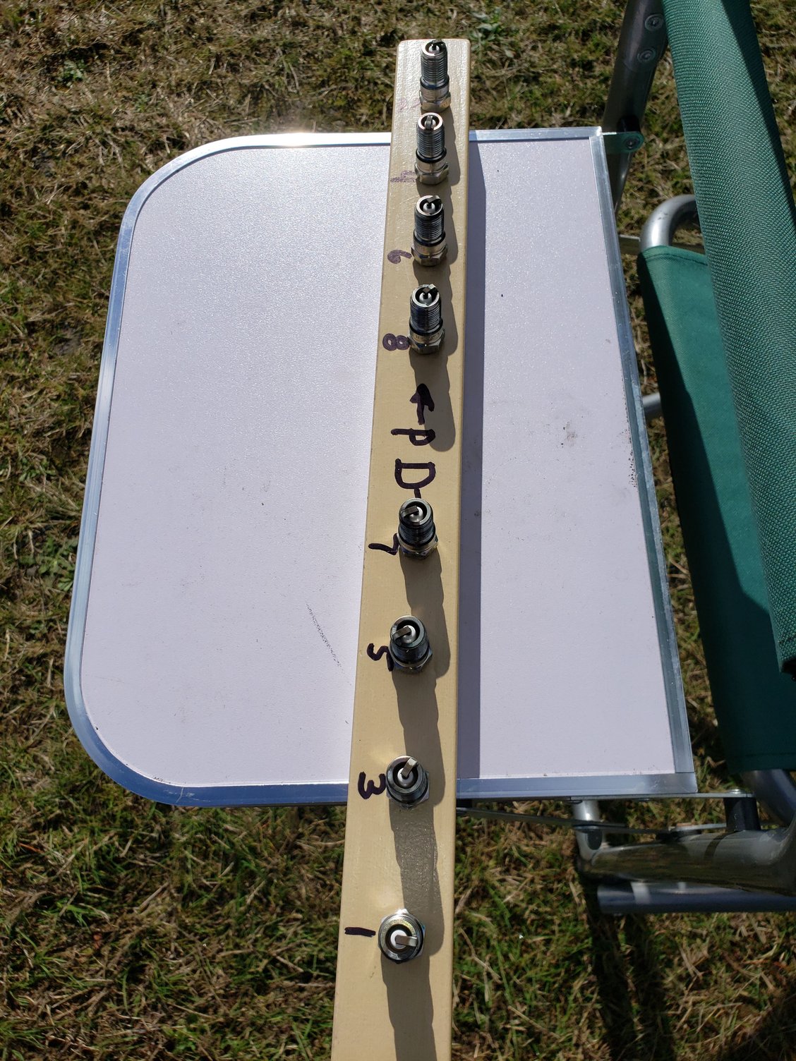

14.1 408. 2 stages on a stinger plate. Dry. It always seems like I get hot holes when I got up to the next tune . Like going from 250 to 300. Its always a distribution issue and I end up pulling timing from a hole or 2 from the back and adding in the front. Here my tuning stick. You can see 1 an 3 look good 5 and 7 I would pull a degree next pass. 8 add 1

Thank you for the advice. I will definitely check it out, and will be making a stick like that lol. I currently have a 6010 so I do not believe I have access to individual cylinder timing. But if need be, I will upgrade to the 6014.
