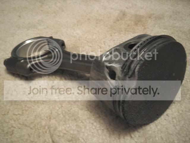

How about Hurting the heads, not my car but a buddies, lifted heads, pushed out a gasket, and here is the aftermath
Attached Thumbnails Has anyone actually blewn their engine/pistions etc????-head.jpg
