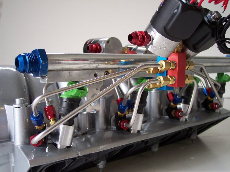

Thumbs up intake teaser shot!!!!!!!
well, this pic might not work, i never cut from an email, saved it and pasted it.
hope it works.
here it is!!!

ok ok ok!! Sheesh not quite finished , trying to get him to replace those scratched up fuel rail fittings Flowing this bad boy now

wowe, so much for a teaser. lol
looking good!!
the second i get it back, i will replace them!
i think you scratched them. lol jk

Nitrous Direct, question (and not meant to be inflammatory). Why did you use teflon tape on the nitrous connections? I always heard, and have experienced, that the tape is not used on nitrous. The prefered method is to use the paste. I had a screen clog up with tape, that I ensured was wrapped in the correct direction and didnt have any excess, its just the nature of the beast.

A combo of teflon tape and paste was used. We always suggest only paste for the novice but oin a job like this paste is used in conjunction with tape, the tape is placed towards the outside by the hex away fromt he inside of the noid to get a better perm seal. Paste is always reccomended period, if you don't the exact right way to wrap tape, then leave it out, but both used together in the right way make for the best seal

as for the tape, i have seen it both ways as well. me personally i wouldnt use it, but im sure if its on very perfect, it should be fine.

looks awsome man...i might need something liek that soon haha
there alot goign on on that intake
are those things after the injectors just extensions?

Nope those are our cup style EFI injector nozzles, see them here
EFI DP NOZZLES
Noyzee has a dual stage setup

oh wow i did not notice that was also a stage...thats just sick man...keep up the good work

Wow that is a bad setup for sure I didn't notice that either!

Man that is just plain sick what size shot is gunna be pumping threw that

Looking Great I was wondering who would end up with a 'Dual'
setup. Now i guess i know. Scott the setup looks very familiar............
i think it's the absence of lines! The 42#s and the EFI
cups look very familiar.

i went with Nitrous direct on this for a few reasons. one is scott stepped up and realy helped me out, answered anything i wanted helped me out, then he seemed as exited as me. he was happy to be doing my setup, and so far im happy with my choise of using ND. as for Cold Fussion, i dont know yet until i try the product, but im sure i will be happy!
yes, those are the cup style under the injectors, im thinking to start the season, the cups will see the first stage of around 150-200, and the new preditor nozzles will be a second stage of about the same.
this is just until i get my new tranny/gear/suspention dialed in. then she will see a little more spray if i need it!
