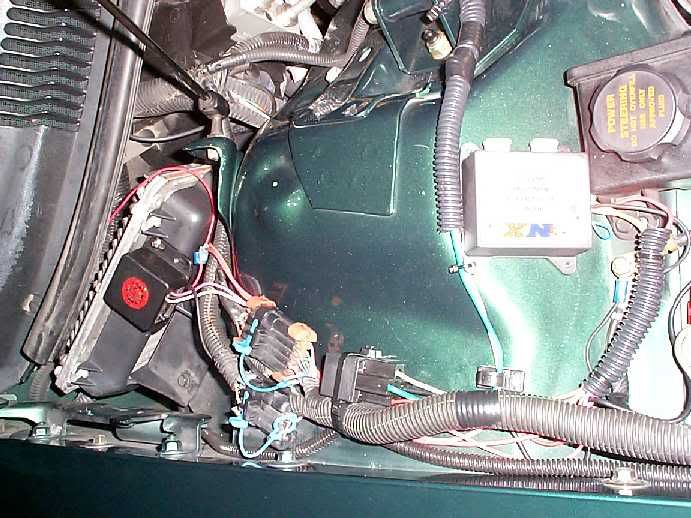

Well I finally got my kit fully installed and it works great. This has to be one of the best systems out there. I would like to thank this forum for all the info and input. I am a NA and Turbo guy and this is my first venture into the world of Juice, and I can't believe I haven't done it sooner. Anyway, I feel like an LT1 nitrous exptert now, lol.... hope the pics help someone else, when they try to figure it all out. The biggest deal was finding the TPS wire and Tach Output wire, everything else was gravy.... I also put the bottle in the rear-seat area, since I wanted quick removal and easy access from inside the cabin. Later on I will move it to the spare tire cubby and buy a remote opener. We made a mounting board and fitted an L bracket. Just remove the bottom seat screw, put the bottle in, and bam, your done. Since it is also wedged under the top seat frame, it is very secure. Right now I am just doing the 75 shot, until I can get some TR6 plugs and a new fuel pump, then I am going to the 150.... ... The install came out pretty clean in IMO....
This pic is not very good, but it shows the mounting position of the TPS and RPM switch

everything looks good, but you need to get some blow-down tubes.
Yup,,,, I was reading I could get some home made stuff, without ordering and expensive one. Does anybody know where I can get the tubing and fitting?
