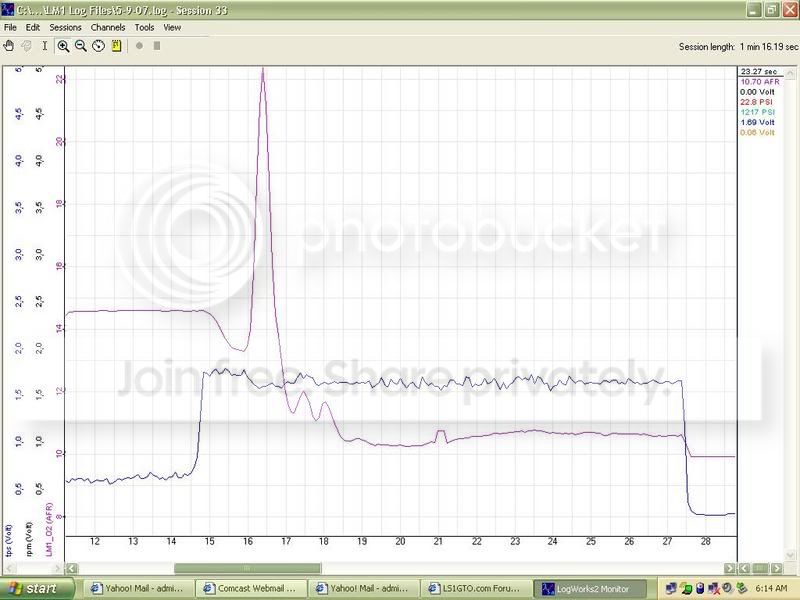

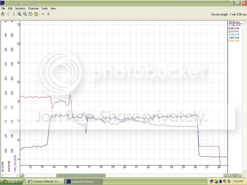

So, I was getting some big lean spikes, and figured I try to put the FPSS after the fuel solenoid and use it to activate the N20 solenoid. It has been discussed a few times here but I don't know of anyone who tried it.
This is on a rail style direct port, and man did it work perfectly! Figured I'd share.
Check out the before and after.
Before
After

fpss is set at 3-4psi
flowing fuel pressure is at 9psi
