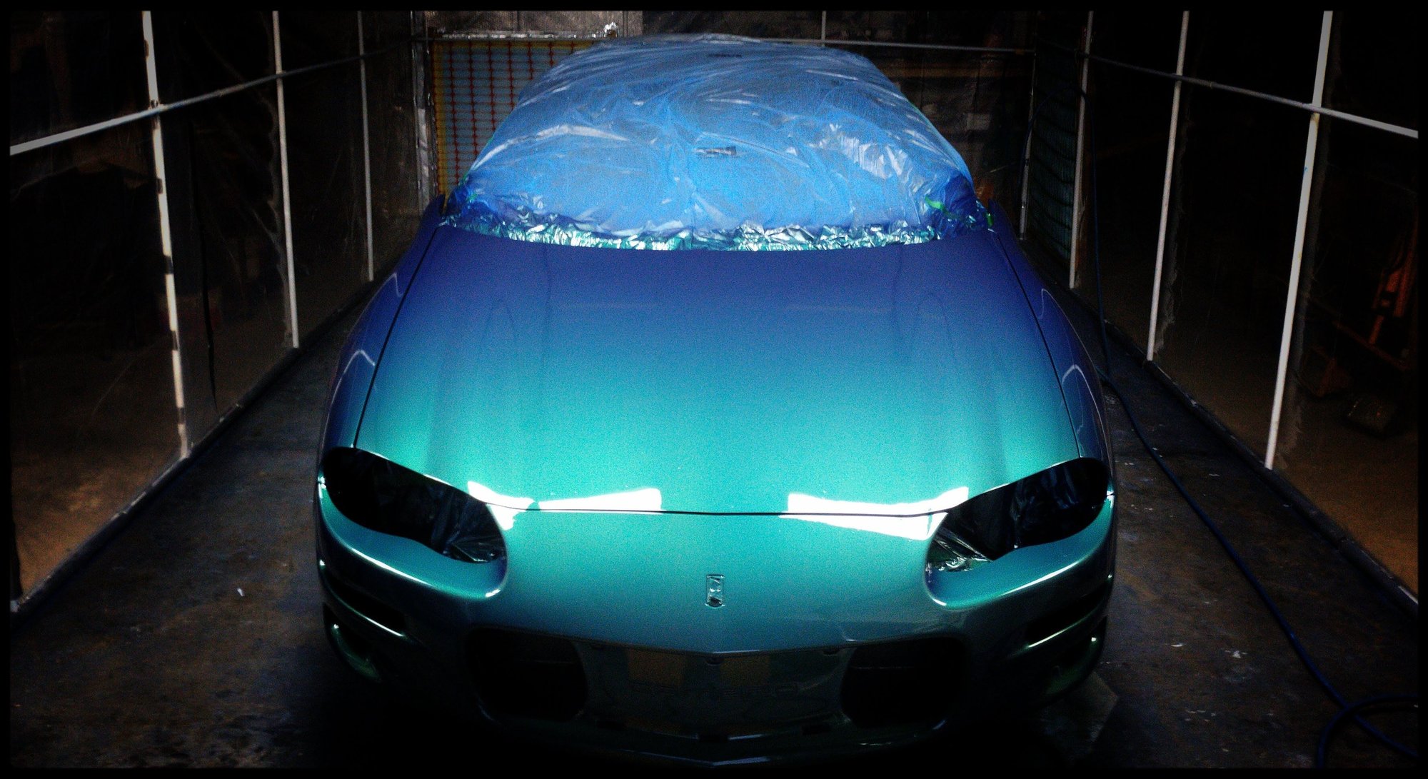

In 1997 Chevy offered the Camaro in "Mystic Teal Metallic" (which is the blue/green color changing paint) and the paint code is/was 79U. Mystic Teal is identical to the "BGC" that was on Pontiacs, though I will say the contours of the T/As etc. amplified the color changing properties.
Not sure if my post count will allow me to post pics, if so here is a pic of my Mystic Teal Metallic Camaro in the garage and you can see the similarities to the Pontiacs above:
I am getting a 98+ SS Spoiler sprayed this week with that paint code, I certainly hope it matches! I will post results when I get them.
