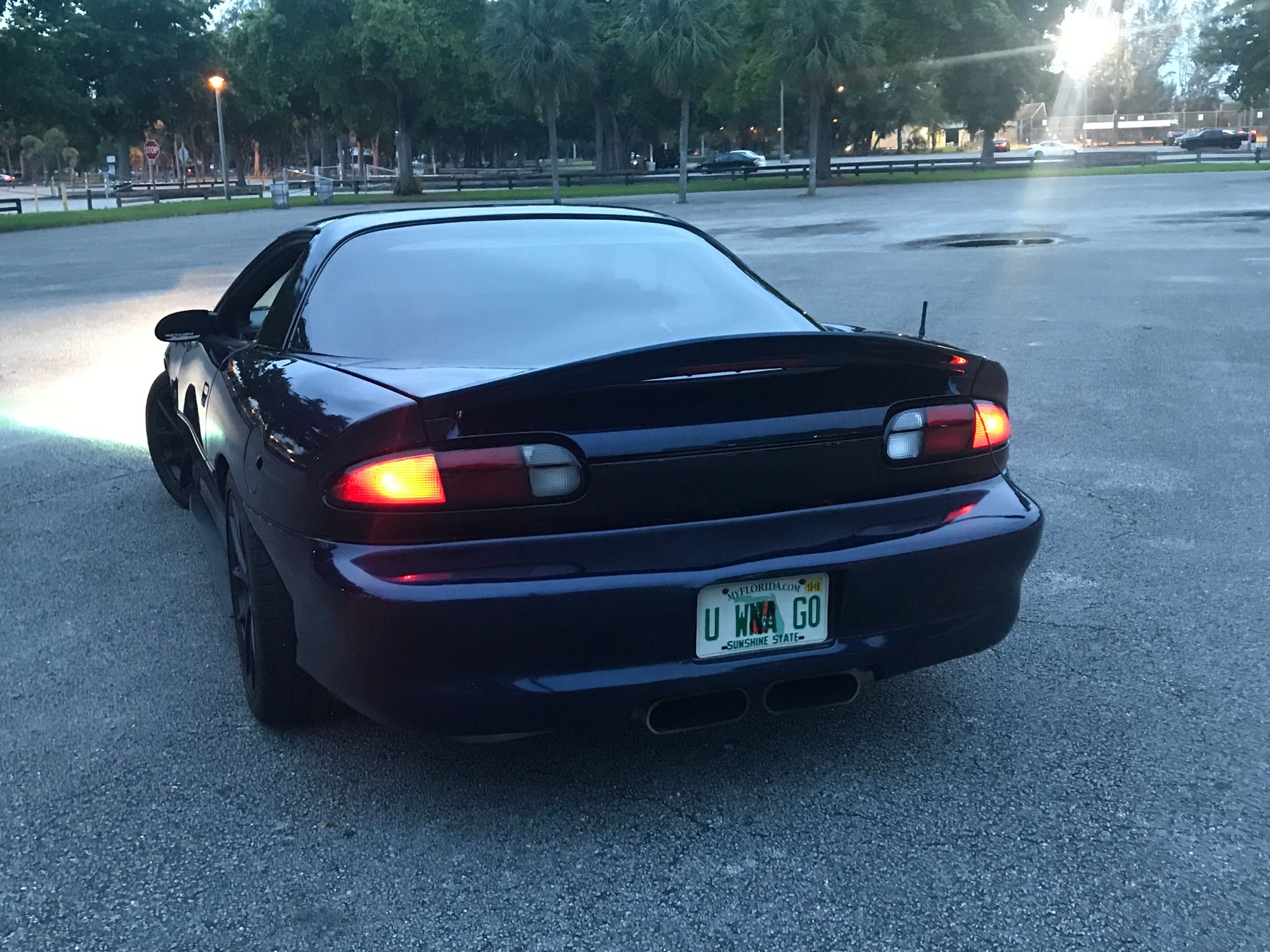

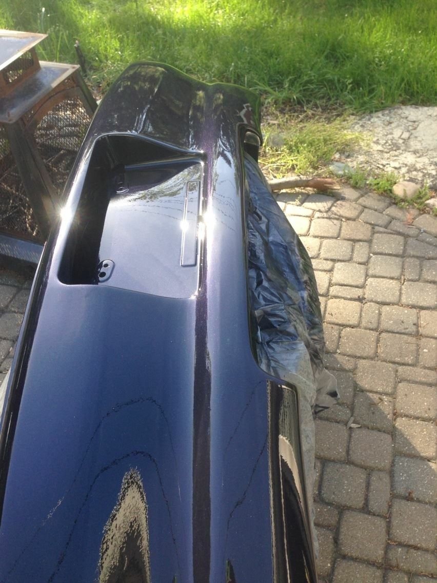

That’s exactly what I did with my 6LE CME valance. I molded mine into my bumper and haven’t looked back yet.

3M plastic panel bond and adhesion promoter. Then I bodied it out with some plastic filler and prime and paint. Thanks it still looks like that to this no issues.

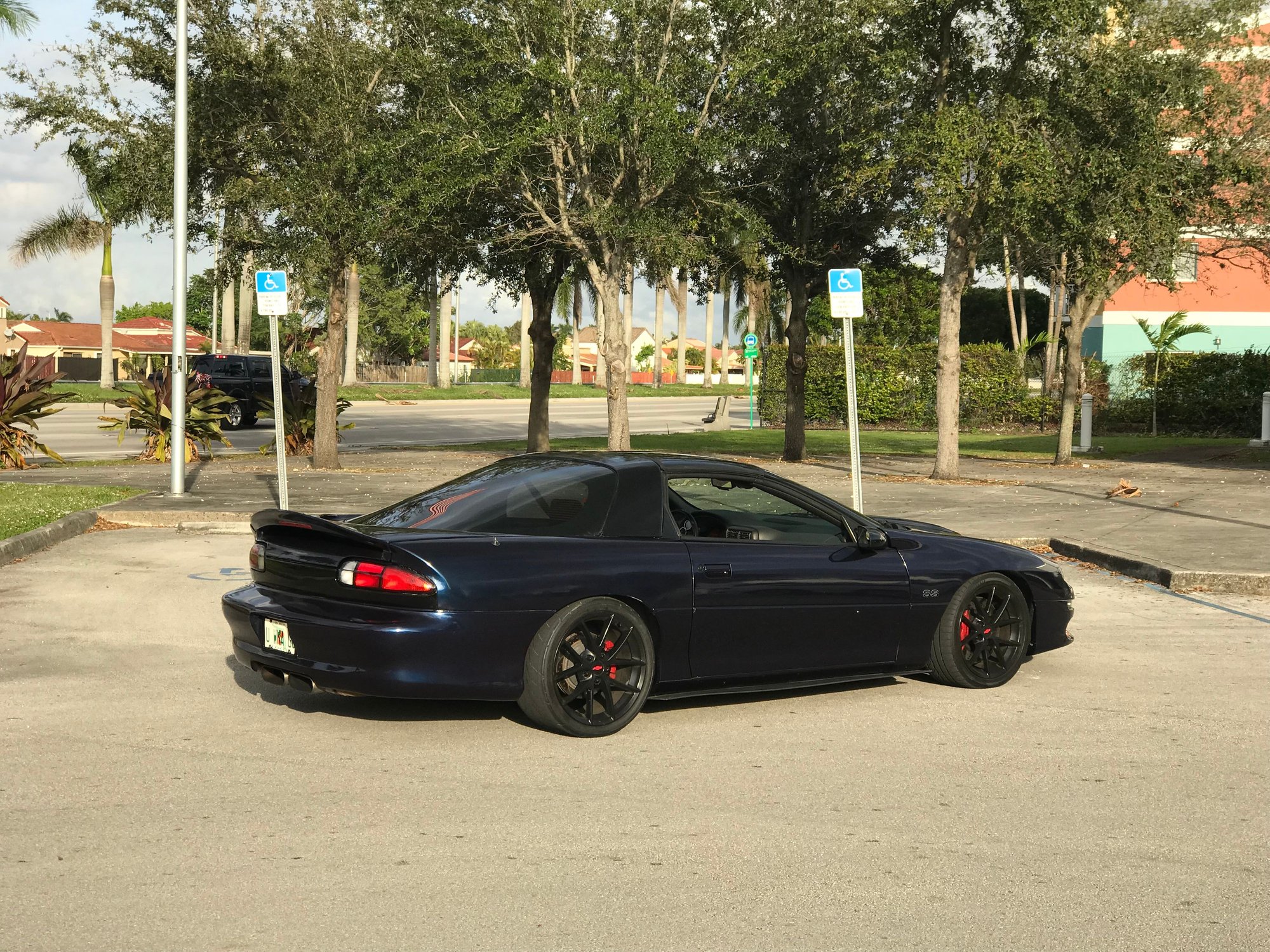

Best mod yet and filled the ugly side markers

looks great with the side markers gone and that spoiler
