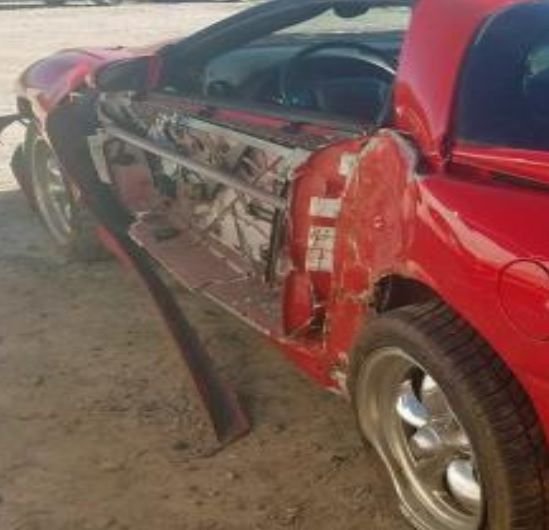

I have an "opportunity" to pick up a totaled 2000..
I know it's tough to say without seeing it, but do you think this vehicle could be straightened out?
I can locate entire non-running 4th gens for $500 in the area and get that is probably a better option but I'd love to fix this specific vehicle. If it is a totally lost cause, I wonder what's involved in retaining the VIN of the original damaged car.... (Like if I get a base model and wish to keep it a "WS6" w/ the original VIN).
Thanks in advance - I am a little frame-ignorant.
I am willing to sink some $ into the car.
Thanks!

There is no legal way to "re-VIN" a car with a different VIN from a totaled vehicle. You would need to repair the original vehicle to retain its VIN.

Thanks, I just got done reading up on this and how the unibody and firewall and everything is one large piece.
Does this "look" bad?
I am going to attempt to pick it up. If I can get it I'll take it to a body shop and see if she can be repaired. If not, I'll take all the parts off and move them over to another project.. (car has had a lot done to it)

Is it fixable maybe, Is it practical no. By the time you spend all the time and money doing repairs to the body and then the cost to paint it you'll be in it several thousand dollars and it's will always be a salvage vehicle. It's a parts car basically.
Edit: Just noticed you said you were taking it to a body shop...………. Uh no..... It's not worth paying someone else to fix it, You'll have twice what it worth in it.

Its probably beyond repair but if the drive-line is in good working order and the car is REALLY cheap then I'd say go for it. Now that's if I was trying to make some $$ from the parts but in the end your left with a big pile of scrap!

You're going to end up sticking way more into fixing it than it's worth. Just from the one pic, you're going to need a new quarter panel, the door jamb pulled, roof straightened/sail panel replaced, rocker panel pulled/replaced, fender, hood, door, floor pulled. You're looking thousands of dollars in body work. There's more there too, that's just a quick rundown. It's not worth fixing. Pull what you want from it and scrap the rest.

Side hits like this are the best for getting a good drive train. As said above unless your father or best buddy has a frame rack and good skills willing to work for beer money it's going to cost way more than the car is worth.

I'm having it sent right to a body shop near me. The owner there said almost word for word what @myk said - it is fixable, just depends on what I want to put into it. (He then told me not to spend more than $250 on it! haha. If he only knew..)
I was only scanning copart from time to time hoping to find a wrecked 4th gen near me so I could get a rearend, LS1 & T56 for my '92, then I saw this and I got a little overexcited... This one is indeed an automatic.. Or at least it shipped that way. I guess I'll find out soon enough what it is.
So... I'm waiting right now. Once it gets to the body shop I'll find out what I've got. If it is a total basket case, I've overpaid for a rearend and an LS1 but I'll have some nice parts to sell... If it is indeed repairable reasonably and my guy thinks he can straighten it out I'll get it repaired.

The unibody looks trashed. Fixable, obviously but I imagine it will be costly. Being a Firehawk though, I'd be inclined to save it if it was possible.

Fixing it! The damage wasn't too bad and my collision guy says it will be like new. I am supplying the parts and paying $4600 which includes full paint job.
