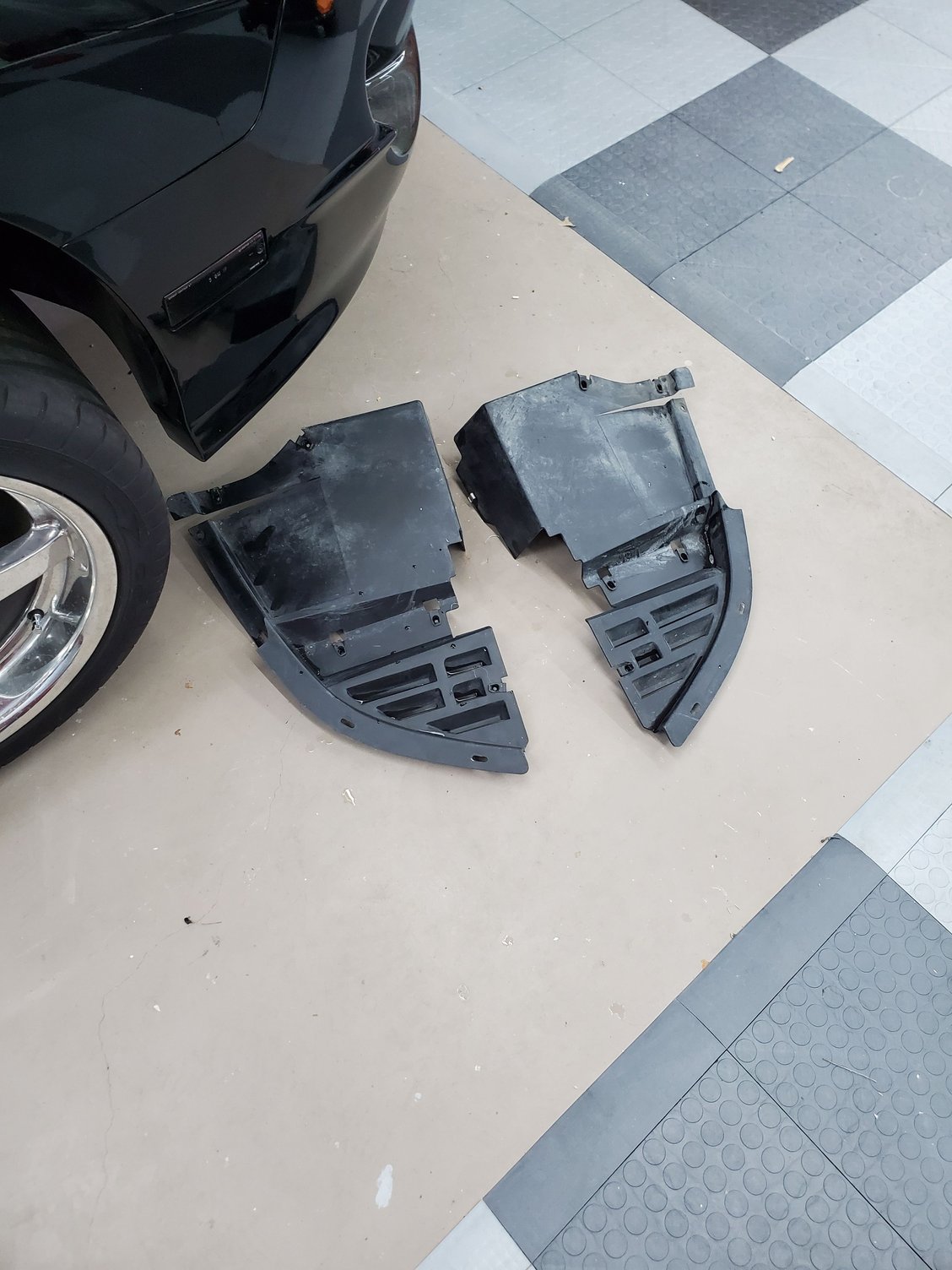

Anyone have a part number the the clips and hardware that attach the splashguards under the bumper?
They are sort of c clips that attach to the underside of the bumper and have threaded portion for a bolt that holds everything together.

a picture of the area/parts you're asking about would help.

these are the panels in the first pic. they mount to the corners of the underside of the front bumper and the edges of the inner fender liner. Can't get a good photo from underneath cause I can't get far enough away.
These are the same panels you acces to change drl bulbs from underneath

Check out GM 11509051, 14101262. The layout parts catalog is kinda vague.
There is also a nut but no part number as they come with the panels shown in your 1st pic.

They’re called j-nuts or j-type cage nuts.
