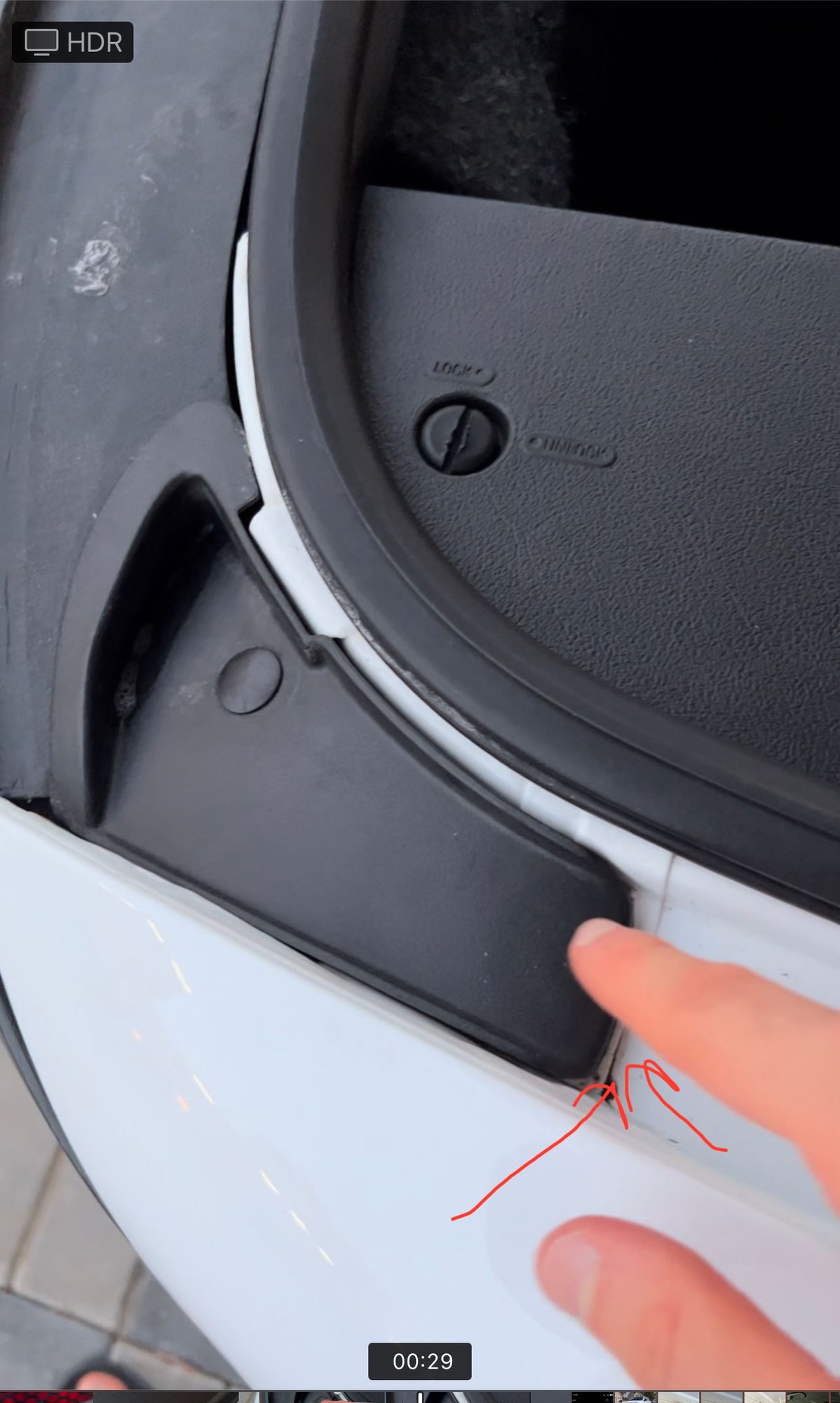

Hello, I’ve noticed that the panel that’s located right above the rear passenger side taillight has a gap between the body of the car and the panel.
My car is a 2002 trans am. And I unfortunately have a dark taillight due to moisture and debris getting inside the taillight, but I’ll fix it later.
just wondering how do I close the gap for a perfect fit. It’s a new platform for me so please bear with me if my question is a bit silly.
if anybody knows the name of this panel please inform me.
Please refer to the below picture, I’m pointing at the gap. Thank you.

Completely unsure what gap you're talking about. Nothing under there looks abnormal to me. If you're pointing at the plastic water drain trim, it's not really a precision fit part and it's not going to fit perfectly.

Sorry, I should have been pointing to the gap between the plastic water drain trim and the body, the other side looks tight and fits perfectly. But the passenger side has a gap. I just updated the attached picture. You can press on it due to it having a gap.
thank you

That's 100% the way the plastic is shaped ( and warped after years of use ), nothing wrong with the car itself. Mine does the same thing. If you want it to fit flush, I'd put a piece of double sided trim tape underneath to hold it down.
