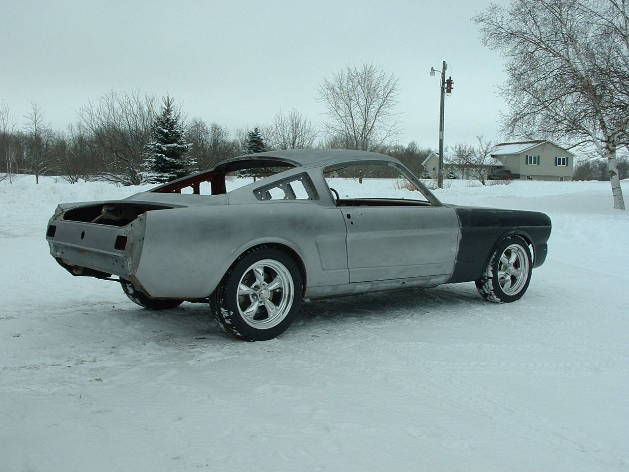

The other thing to consider is the color you choose is a solid or metallic or solid color.
Metallics need to sprayed with all painted parts bolted to the car/truck. Solids can be sprayed off the vehicle in parts.
Again at the body shop I help at I have not touched a paint gun or mixed paint but I know when they spray solid colors on a hot rod project they mix enough color to paint the entire project car or truck so zero chance of a color mismatch.
I've done a number of down to the bare steel hot rod projects. I always joked I'm in charge of taking paint off not putting it back on. LOL.
Couple of pics of down to bare metal. 66 Mustang and 68 C10. Prior to supervised body work and priming.
