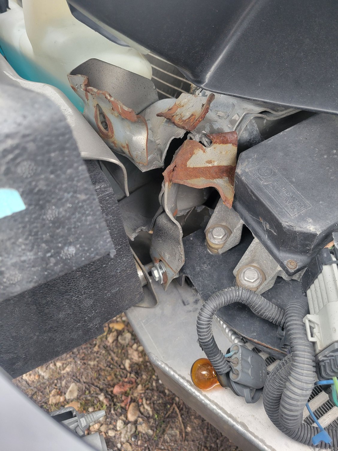

Can you get a pic of the weld section you're referring to? Without seeing it, im curious if this section is an LS1 fbody thing. I know they changed the front support for the lid assembly. Again, just a random guess.

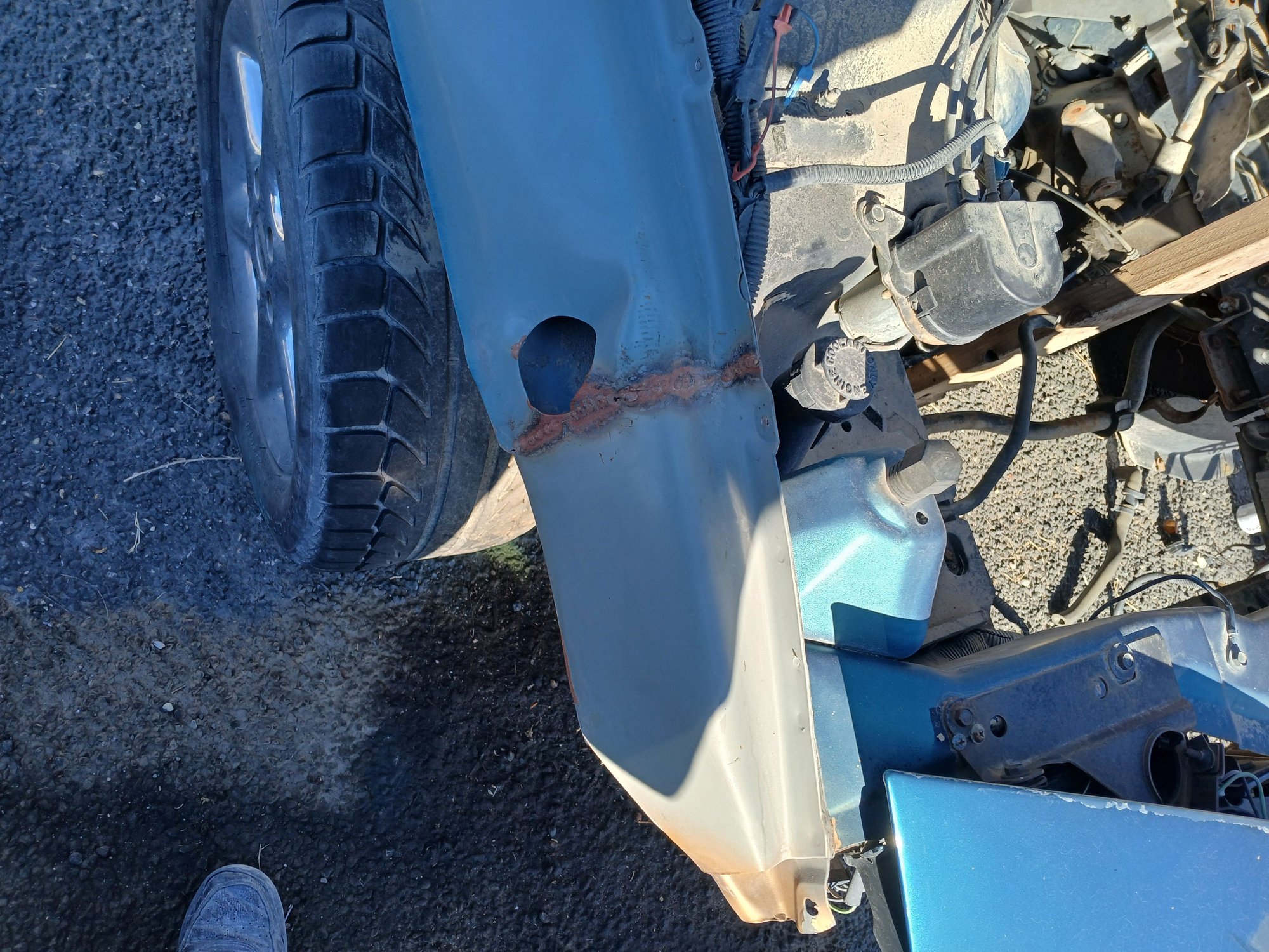

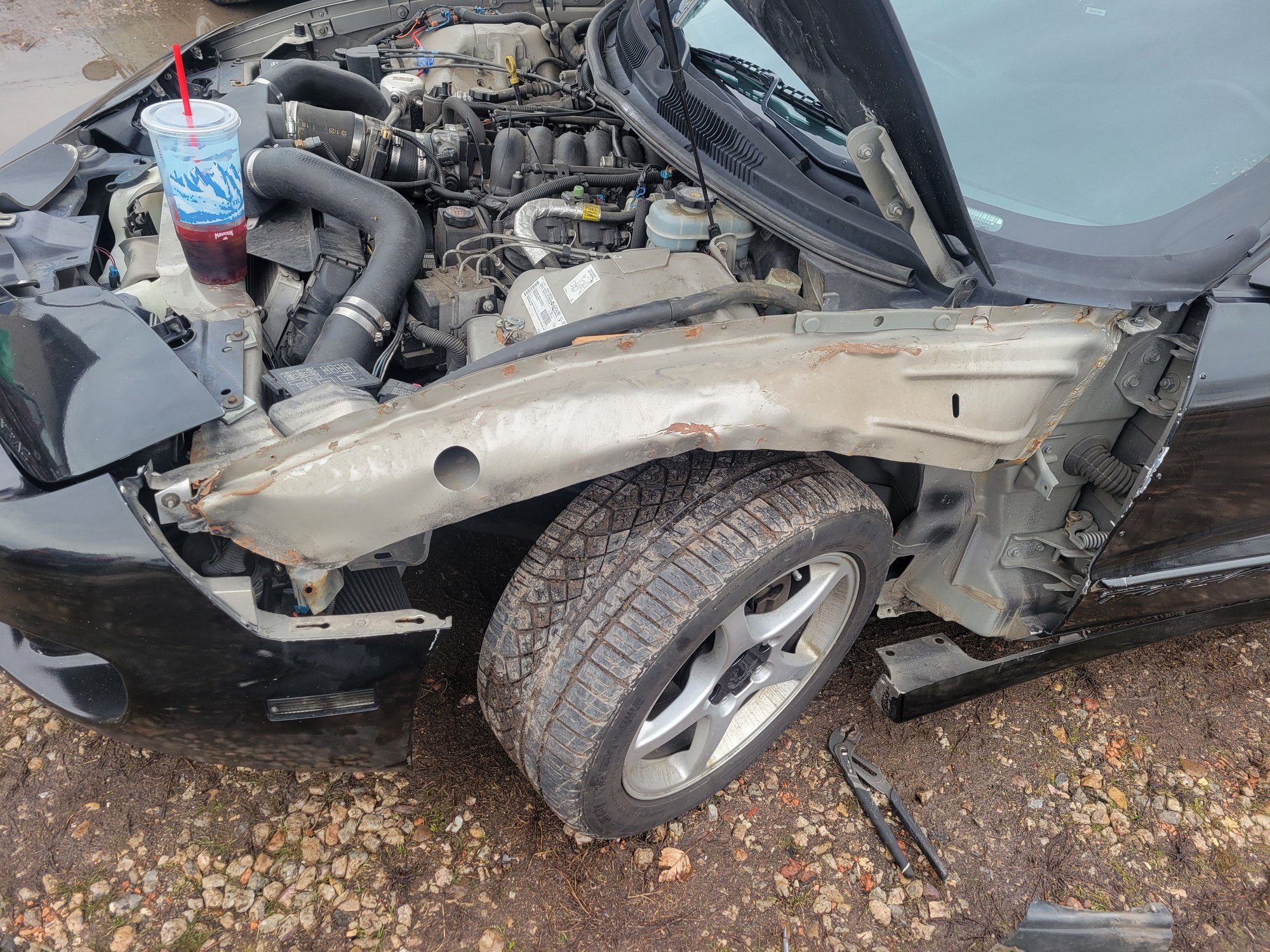

I cut from just behind the welds. I got all that, the proper TA bumper, foam pad, lights, brackets, the plastic at the base of the windshield (forgetting the name), and the little rubber piece at the base of the antenna, plus all i cut out that should fix my crash damage, even left the headlights on for 460. My TA is a daily but I'm hoping I can at least do some disassembly soon to make sure I don't need to go back and cut more but man It's SO cold here right now.

I meant to respond to this last week, my bad. But my response won't bring any answers to you. Those welds don't look factory. They should've been ground off or at least have a quick cost of seam sealer. Only thing I can think of, the factory converted the last lt1 inner fender parts to ls1 style. But again, why would they leave them so rough. Most likely, the car was repaired the same way before.

yeah I think this car was wrecked and they did the same job i was going to do. I took my fender and bumper off this weekend and it's just carnage. I need a whole fender rail and whatever the bigger frame piece is that runs more centered. My best bet would be a roller and swap everything over but the car is on a loan so it's complicated.
I found big stacks of washers, self tappers, and a literal wood shim.
