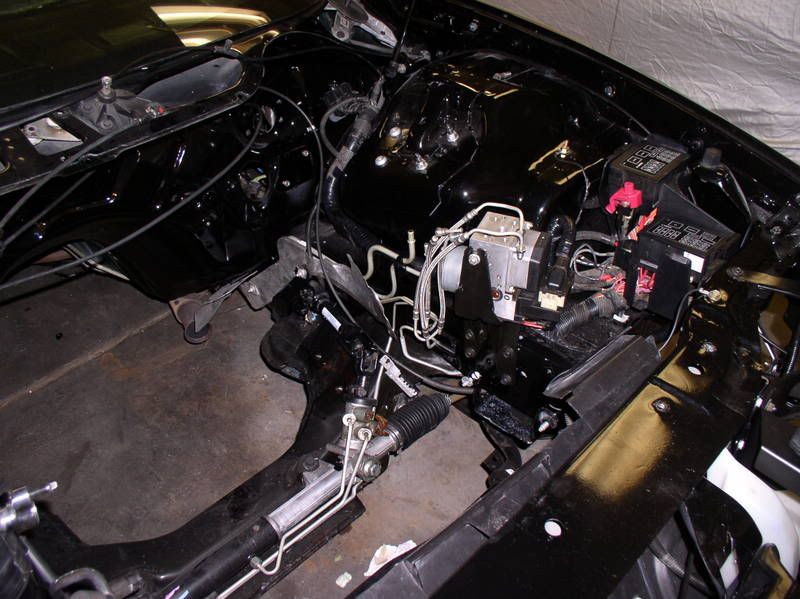

It is not that bad if you can get away with just replacing the upper section.
I believe, the replacment units know come in 2 sections, upper and lower. The last one I replaced I cut from a donor car and cut it out at the frame rails. But when it came time to install it had to be cut in half, upper and lower. It was that or take off the front frame rail support fittings.
What helps is if you can take some referance measurments from another car. So you have something to go by for the re installation and location.
Here are a few shots of my what I went through.
When and if you get a replacment unit. Stick to a Gm part after market units can be a big pain.
Prior
Durring-donor fitted up
If you look here you can see where it needed to be cut at the frame rail to be installed. Ie lowere section and upper section.
Checking final fittment one more time.
After paint:
