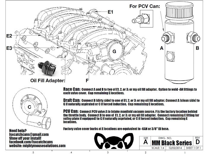

Originally Posted by 2xLS1
Depends on where the other end of that line goes. Any line in front of the TB blade as part of the PCV system should be going to a valve cover nipple.
I take this back. I am running mighty mouse's draft catch can so I have one hose from the valve cover going to the can and the hose from the CAI also going to the can per his instructions.
http://static.wixstatic.com/media/dd...0_0.00_jpg_srb

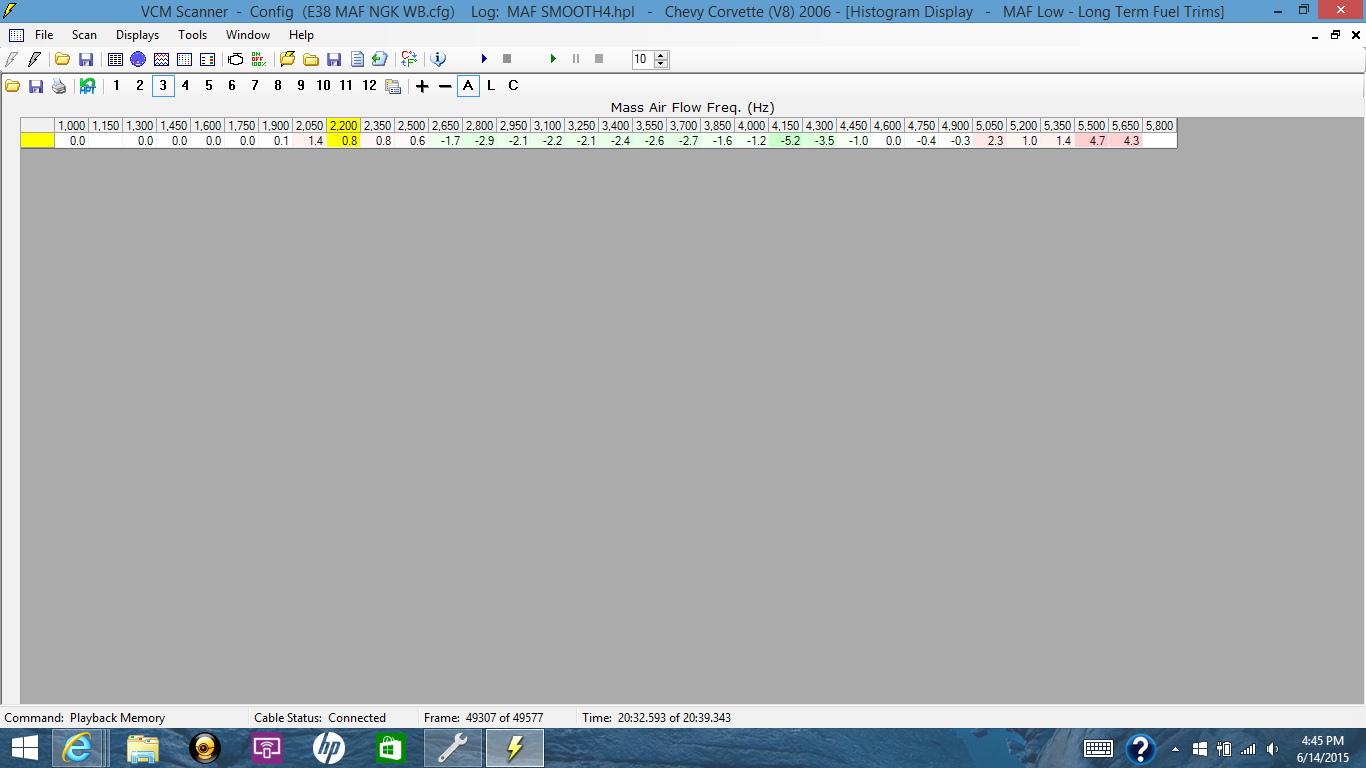

8-13 rich. I thinking thats because the ZO6 mf table is for a ls7 vs ls2 so a lot more air. But keep in mind i'm still verying that the histograms are set up properly. I say that because my lambda error is small. If i'm commanding 1 and gettin .98-.97

dialed in my low MAF table using LTFT. Here is what they look like.
Here is my theory. I loaded the MAF table from a ZO6 which we know is a ls7 427 vs a ls2 364. So my computer was thinking it needed more fuel than required (I pulled a lot) as it was calling for so much air volume. And that is what threw the PO101 code that the MAF was out of range.
Now, if this theory makes sense, then I still need to tune the high table which I will do via my wide band and lambda error. Then I need to run it hard again as that is what I was doing when I threw the code last time.

DRAFT is not a PCV system, there is no fresh air inlet on DRAFT, therefore everything going through the maf is fresh and accuratley measured. All good!

And the arrow goes towards the throttle body. It is showing the direction air should flow through the maf.
