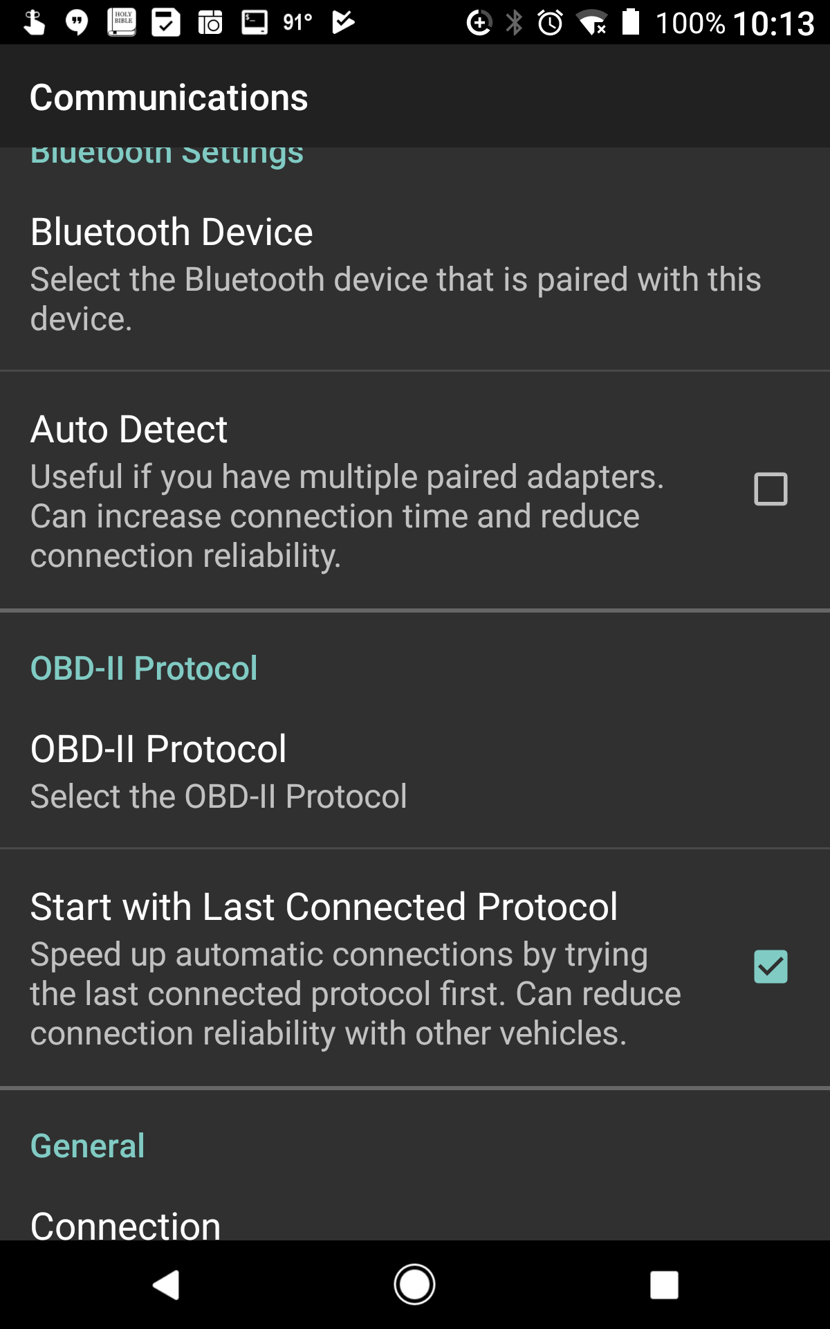

Which adapter; which software?
My ScanTool has an option for re-scanning at startup, that I think says it's for multiple vehicles. Maybe yours is set to 'use last ecm' or the like?

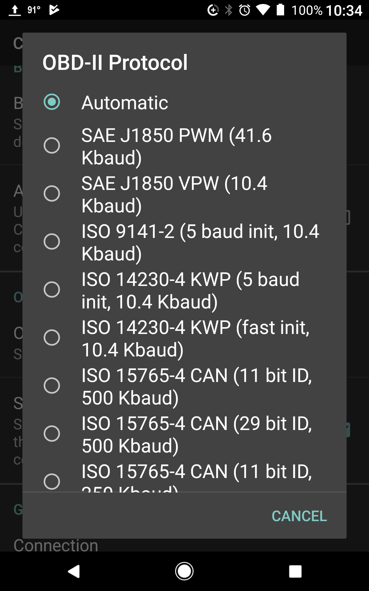

Or maybe it's the OBD-II Protocol setting:
