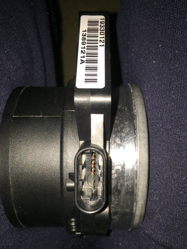

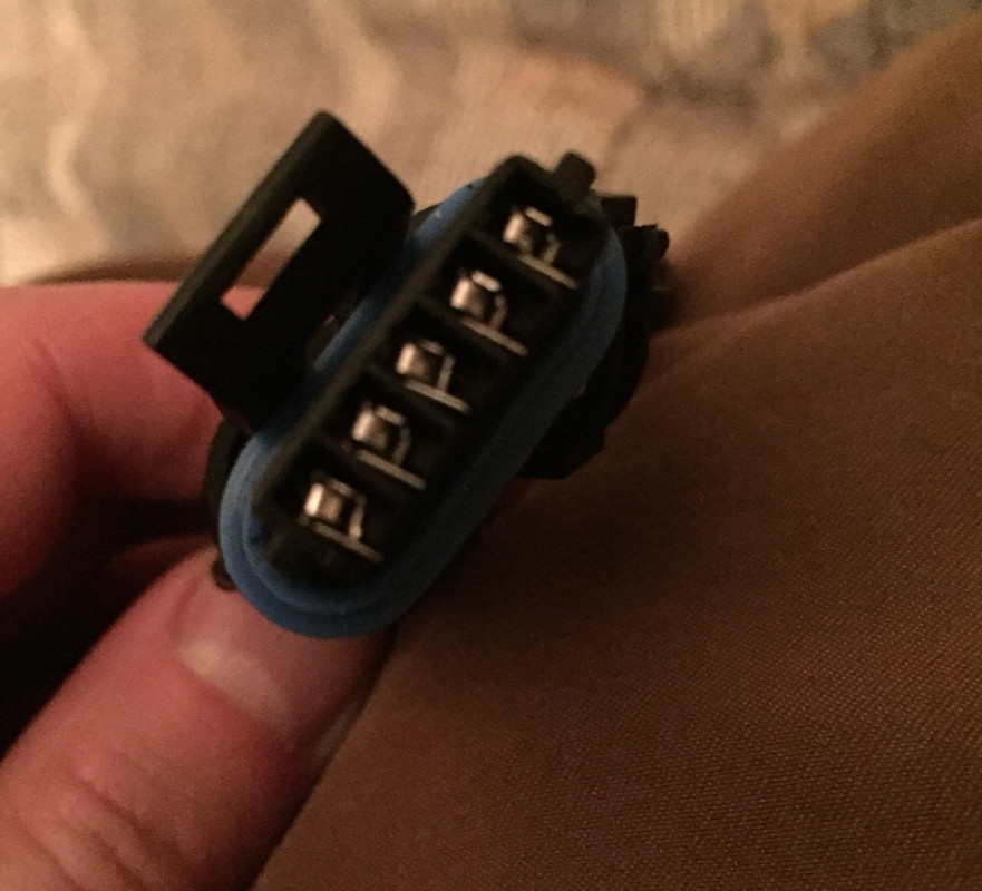

I bought an 85mm maf (Delphi 19330121). Which part number is the correct one to convert the ls1 wiring to to the 5 wire?
This one is the one I bought it doesn't fit (LS1 3 Wire to LS2 LS6 LQ4 Vortec to 5 Wire MAF Adapter with IAT Signal)

U need a ls1 3wire female to a truck 5 wire male.
if u can get a used pigtail off another harness u can wire it to work. And keep your original seperate iat location. Brown and tan wires on the end are the iat wiresfor the 5 wire pigtail.

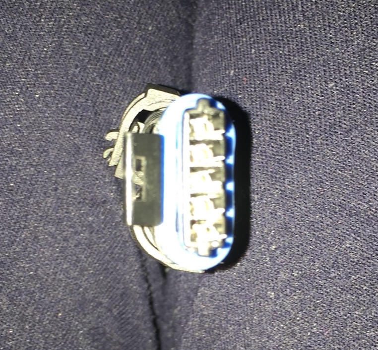

That would be fine, but I can't seem to locate the correct connector for that MAF. it's the 85mm maf that Hawk's sells, but none of the connector I find are the correct shape.

Cant shave or trim connector to make it fit?

That's where I started, but it doesn't look like the right one. In any case I think I found it.

Found the right part
WLS046 LS1 to LS2 or Truck MAF Mass Airflow Adapter Harness
