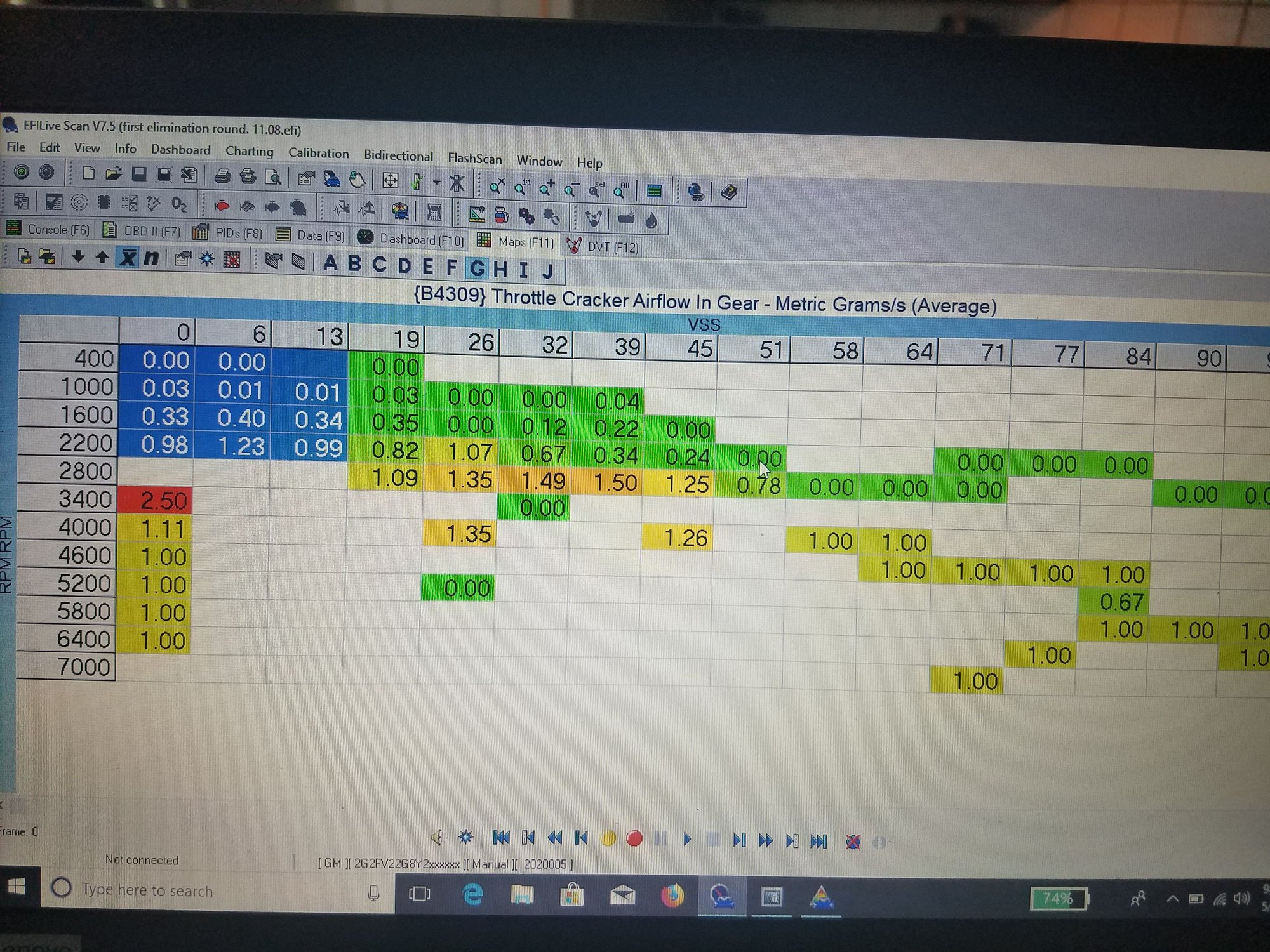

I've nailed down my tune pretty well and now just has a surge driving down my driveway in gear but off the throttle (gravel and dust flys).
I logged throttle cracker airflow in gear vs rpm .
the numbers in that map, copy then paste and multiply to get what the motor wants ?

post file and log
