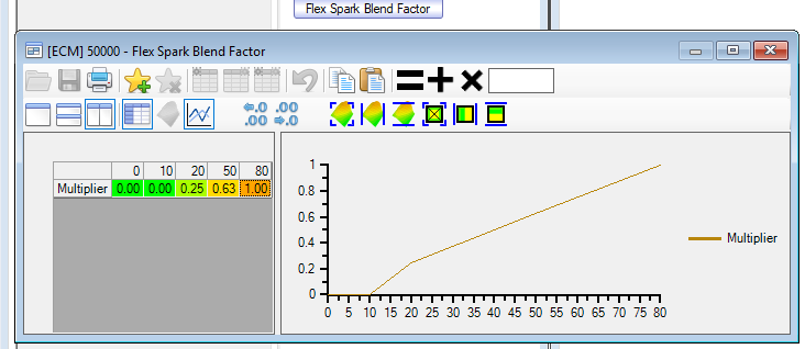

Those having spark related issues it's more than likely due to this table not accessible in HPTuners without adding it yourself in user defined parameters.

I figured that existed. I saw at e55 that I wasnt getting all the spark and did a little math. It lines up with that table pretty well. Good find.
the spark related issue Doug was speaking of was in regards to logging the flex spark. No pid is available in hp.

The Flex advance PID is there, HPT just doesn't have it added to their scanner.
