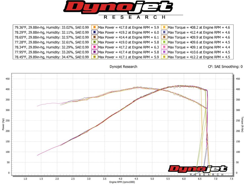

I'm in the process of having my motor rebuilt from ground up and I decided to change the cam (specs below). My overall question is ... What would the level of difficulty be for me to do the tune myself. Last year I asked for guidance on tuning my stock LS3 with 1-7/8" header and based on feedback I was able to pull it off. I was pleased with the results and the car ran strong. My detail questions/process are below and I appreciate any feedback.

Here are the dyno results from my bolt-on's setup.
Smoothing = 0
Smoothing = 3
