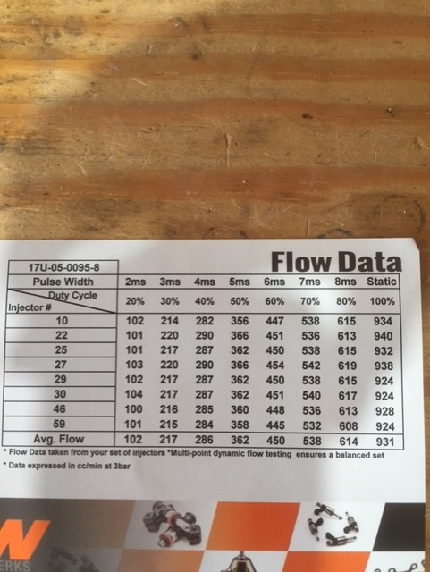

You will get a card with the flow data for your actual set of injectors with DW. Here is mine as an example...
