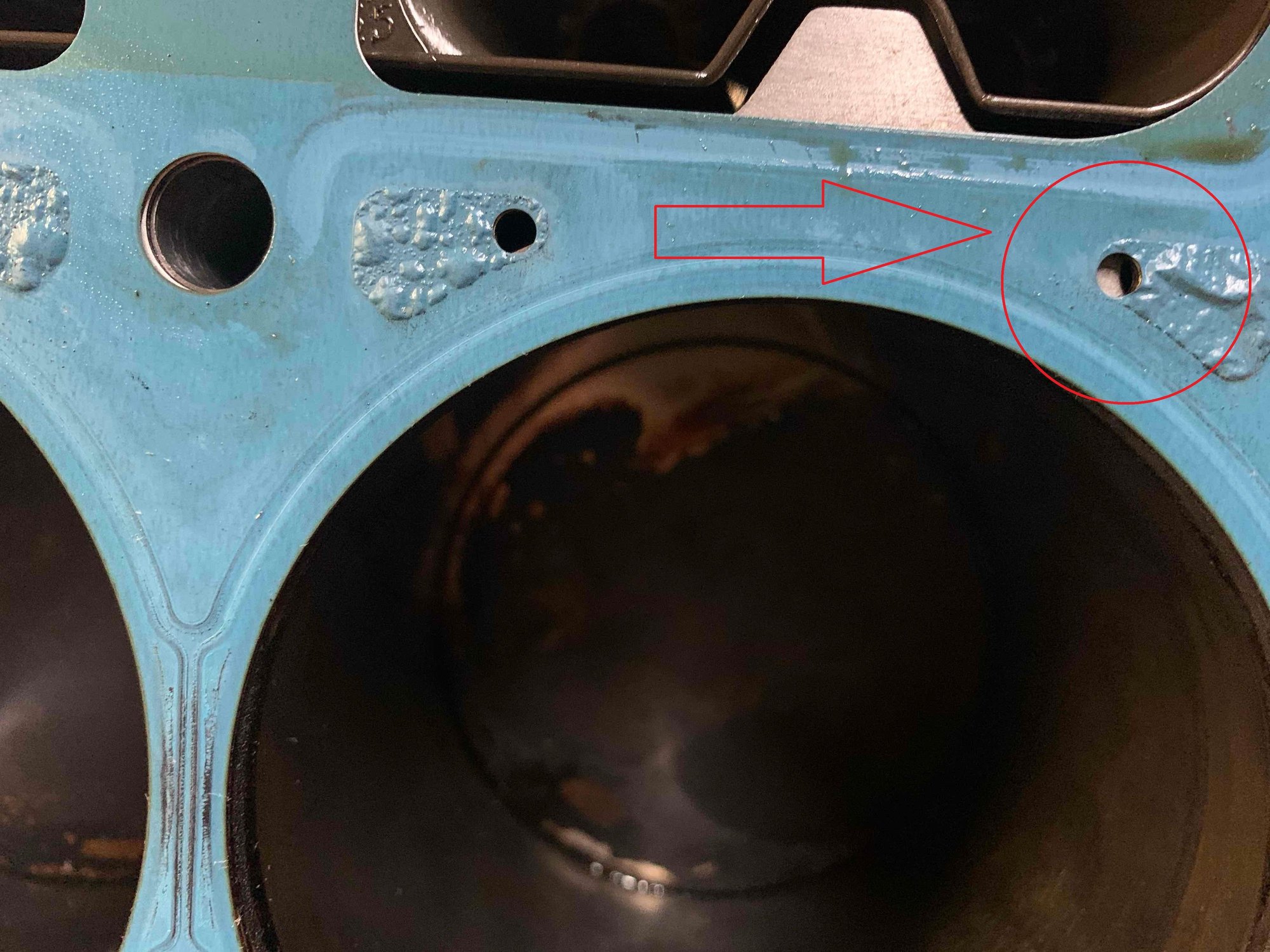

This is what they found regarding the Head Gaskets. Everything looks like it matched up except It looks like in the back, one of the cooling channels was partially blocked in near the rear cylinder .. only one on each bank though. Do you think this would have been enough to have caused the overheating?

Any thoughts?

It's not going to help lol. Get it back together and see what happens!

Yeah, that feed hole being partially blocked isn't helping anything. I would also do the cooling mod on head gaskets to feed additional coolant on the exhaust side too (especially if you plan to push the combo w/ forced induction in the future). Curious - are you paying someone to do the diagnostic work? A good test plan should pin point what the root issue is. Paying to try different things is a bummer.

What is the cooling mod on the head gaskets? I looked into it but couldn’t find. Yeah I am paying. I was basically trying everything else I could before removing the headgaskets given the much larger difference in costs but I ran out of options before pulling the heads.
