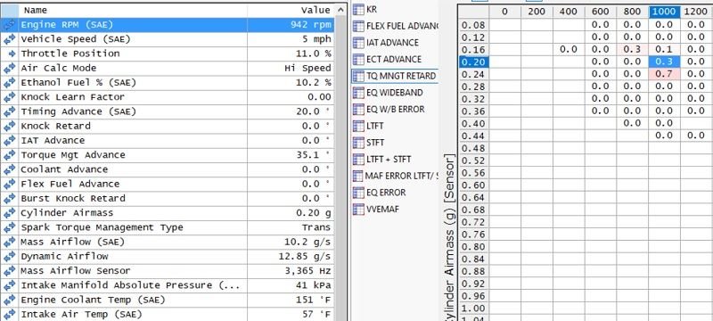

Trying to touch up a tune on my daily driver 2008 Silverado. 5.3, with a muffler swap, lol.
DoD Disabled...

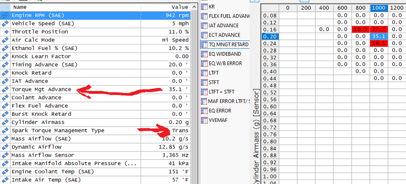

No matter what RPM, what MPH, what gear, what-EVER...I get almost constant TORQUE MANAGEMENT SPARK RETARD.
On the LOG, it says, "SPARK TORQUE MANAGEMENT TYPE.........TRANS, when it is removing anywhere from 3* to near 20* of timing. I THOUGHT I had every single ENGINE & TRANSMISSION spark related torque management parameter turned OFF, but evidently not.
I cannot, for the life of me, figure out how to ELIMINATE THIS...It should not be subtracting timing idling or drifting at 5mph...Truck has tank of 93 octane unleaded, does NOT burn oil, does not have any blowby, does not TAP, does not have an exhaust pipe rattling, and does not get any actual KNOCK RETARD, just this Torque Management BS, which sucks the life out of this thing, power-wise...
I attached latest log and reflash below.
Any help would be greatly appreciated!!

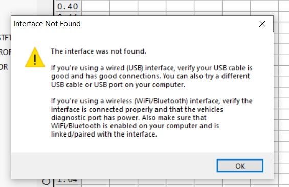

I had to update software to be able to open that file...Reflashed that tune to the truck. Then tried to "Write Config" to the interface so I could log on drive to work tomorrow morning
Now it's not seeing my interface. Tried resyncing interface, restarting laptop, reconnecting all wires, online, offline, and doing a headstand...nothing...

The laptop has no problem whatsoever connecting to the interface ONLY, via the USB port, and original HPTuner supplied cable. Also no issue connecting laptop to interface only, using an aftermarket, much longer USB cable. It is able to "GET INFO" from checking the interface (although it's empty of logs, it is connecting and checking), so maybe it was just a fluke?
It's pouring down rain, with remnants of the latest hurricane, so if I catch a spot where it's light rain, I'm going out to see if I can do the WRITE CONFIG and actually log.

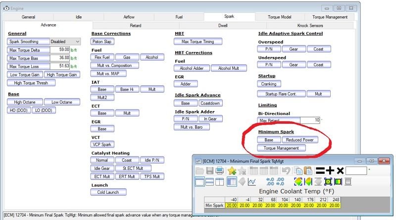

I didn't look since I'm at work, but assume you have all the tq mgmt % tables zero'd out. Did you also raise the spark - minimum tq mgmt table? Believe stock its set to -20* I usually bump it up to 6-10* depending. Even with tqmgmt off I've seen it pull big timing trying to shift.

Just for the heck of it, I am going to set the Torque Management Minimum Spark to 25*, which "SHOULD" still allow it to retard for any other reason, but should keep it at 25* minimum, whenever this stupid Torque Management Retard kicks in...

log base timing also. and maybe the torque converter perimeters? going into lock may throw abunch of torque management
something is fucky, but im not sure what lol.
youre histo is tagged spark retard but the perimeter youre logging is spark advance. looking at a few random spots in the log the only time the spark advance matches the spark table is when the additional advance comes from the trans spark advance

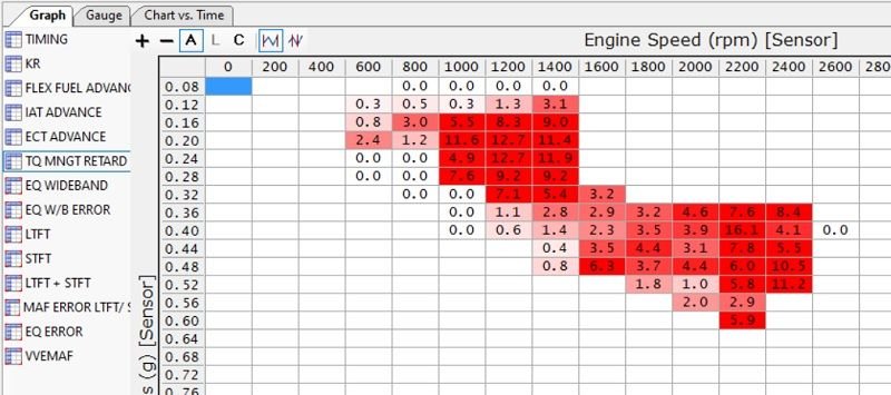

I'll try logging base spark...
The latest log started at -35.7* retard at about 10 feet out of my parking spot, BUT...
The Torque Management Spark retard never came back...which is the 1st time it hasn't...
1st pic is 12 seconds into the log, the 2nd pic is data from after driving 12 Minutes...
Attached latest log too.
