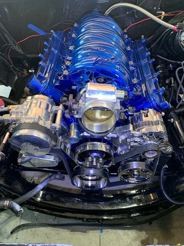

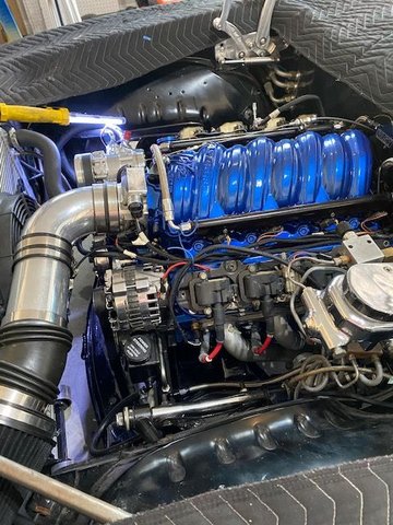

Just finished and installed my Dart LS Next build and need help with base timing parameters. I have read and watched lots of tuning videos recommending an idle timing of ~24 degrees and all in at 31% by 3500 rpm. Given the intake and heads I don't see a lot of reason to spin it past 6500 rpm. I am not intending to race, cruise and show mostly, some burnouts of course. Any insights or recommendations are greatly appreciated.
Dart 31867211 block
Bore is is 4.125
Deck 9.24
DSS Pistons K1921-4125 +10CC volume
Eagle 6.125 I beam rods
Lunati Voodoo 4 inch stoke crank
BTR .051" head gaskets
BTR Stage 3 N/A CI+ camshaft 239/254 .631/.610 114+3
GMPP ported heads
FAST 102 LSXR intake
FAST 102 throttle body
FAST EZ LS 2.0 computer
Tremec T56
