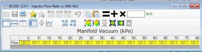

I know the Injector Flow Rate vs. kPa will (should??) need modifying. It's already set up for the 1:1 regulator, using the number provided by Greg Banish.

If the tune was well sorted, it should track pretty well after entering the new flow rate.
Might have to rub on the VE a bit

IFR is really the 1 impacted by FP. Some of the other parameters can vary slightly, but as Ron said, a tweak to the VE will resolve that as far as you're concerned.
