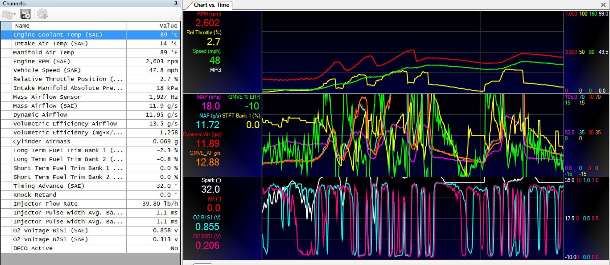

The area in the screenshot under the cursor is about 43 seconds into the log file. If you look at the attached tune, I believe I've satisfied the ECT, cyl air, rpm, and speed requirements to invoke DFCO, but it's not happening.
The TPS requirements for DFCO are between "0-200%" in the table in the tune file. I'm not sure what sensor that 0-200% applies to, since there are many channels that log various representations of TPS. I could start blindly raising the table values for DFCO TPS enable in the tune, but if somebody knows exactly what channel I should be logging, please speak up now.

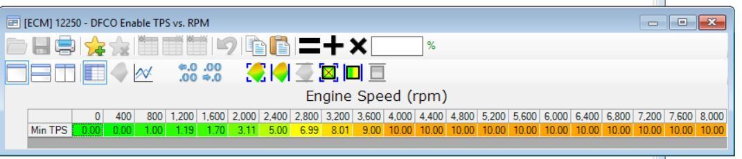

Your current TPS Enable settings are too low, and you will never enter DFCO . Requirements are ( [ECM] 12250 - DFCO Enable TPS vs. RPM: Throttle position must be below this table value.)
As an example you can use similar values as the screen capture

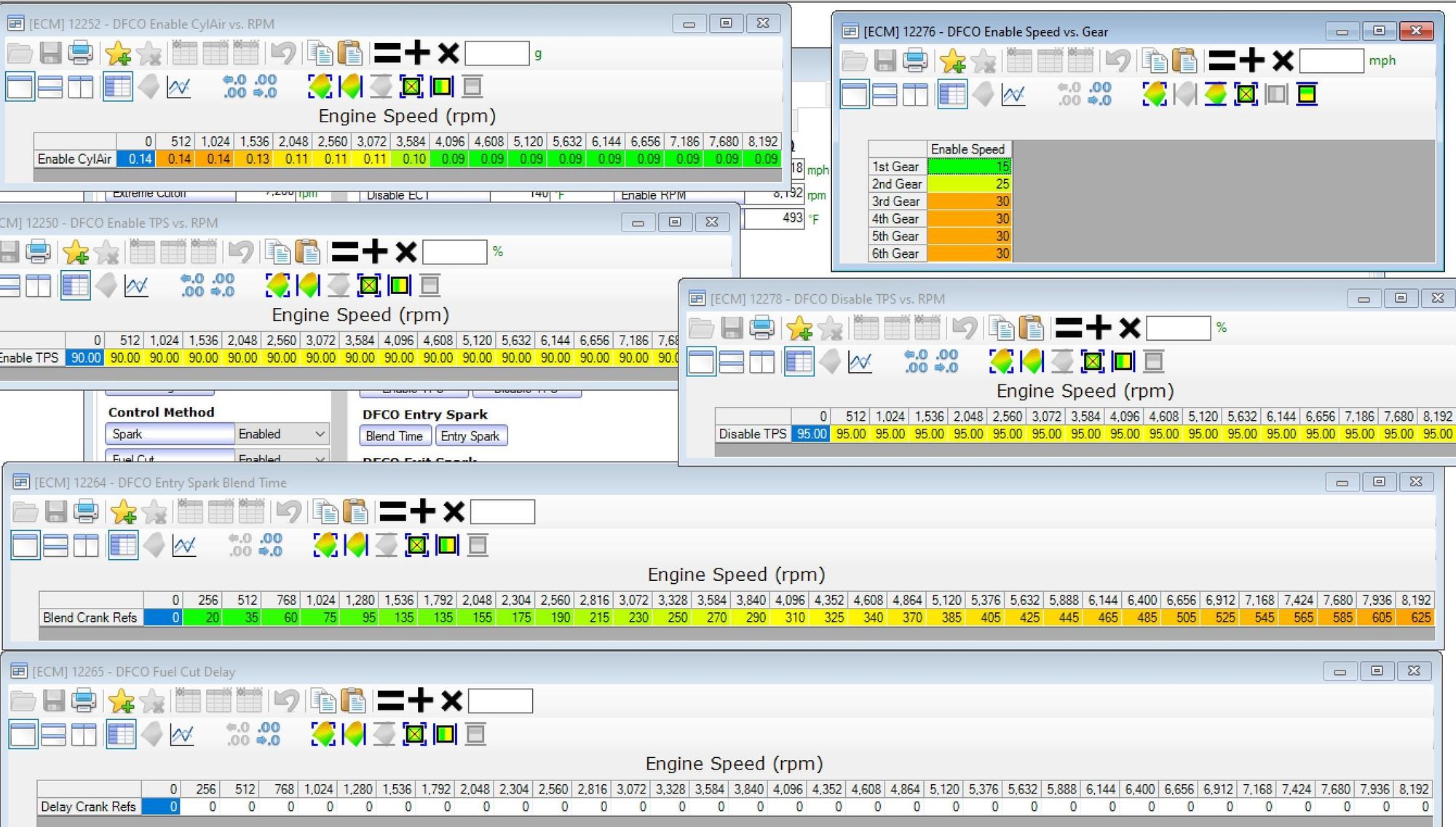

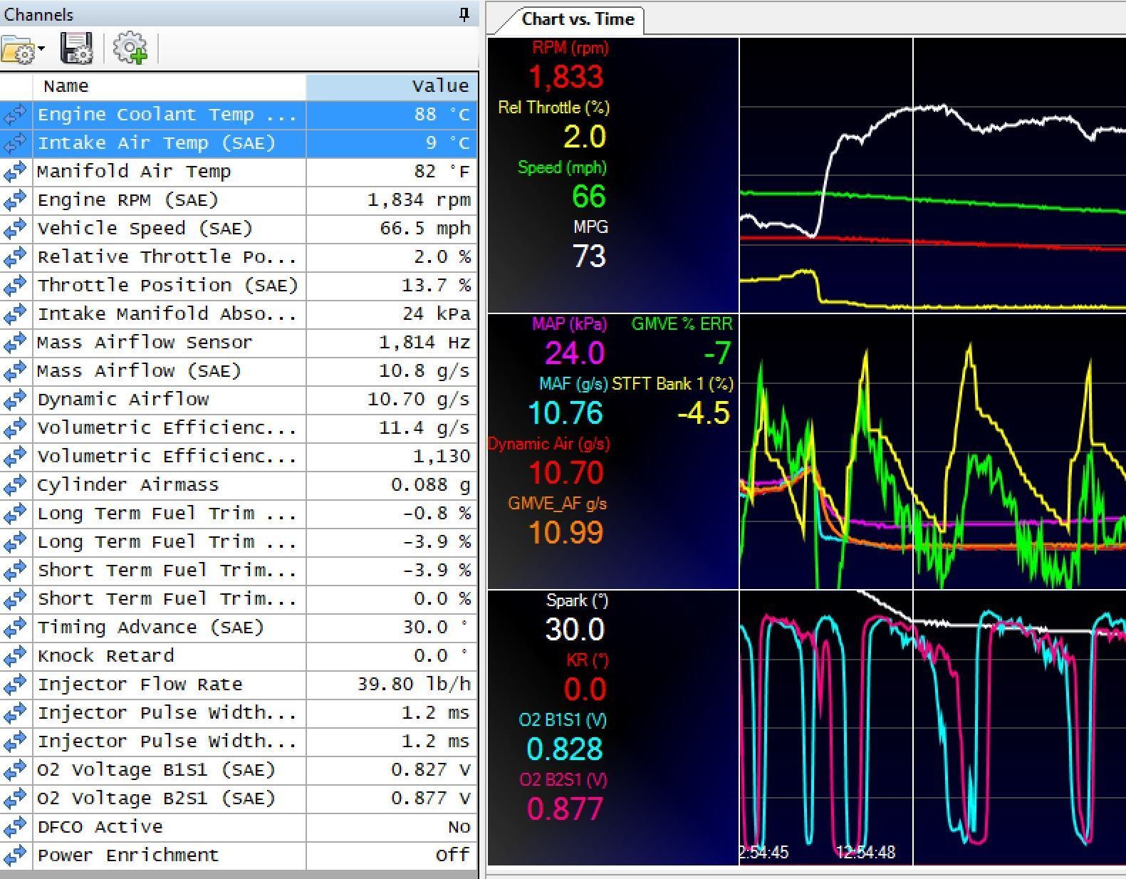

So here you go. This is a capture of the log, and a screenshot of my DFCO set up.
I'm in 6th gear, 66 mph, so that should enable DFCO. I'm at .088 cyl air at 1833 rpm, so that should enable DFCO. I'm at 2% relative throttle, and 13.7% SAE throttle, so either one of those is less than the 90% (!!!!!!) I set the TPS threshold to in order to try and take TPS entirely out of the picture. You can see I have ZERO delay for fuel cut.
Still no DFCO. Does anybody know if the GMPP LS376/480 controller even supports it, or did they turn it off for the aftermarket (GMPP) controllers?
YES, the temperature conditions and rpm conditions are also met.
Do I need to set minimum injector pulsewidth to zero or something???
Thanks,
Mike
