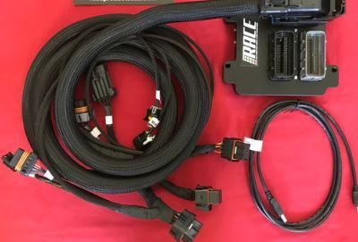

We now have a plug n play option now for 5th gen camaro's to install a Terminator X Max or Dominator. Only thing you lose is cruise control, traction control and one touch start. Will even work with 6l80.

No you unplug the E38 and plug in a module that plugs directly into holley.

Can you share pictures?
does the module have the can translator and other electronics built in?
Old Nov 15, 2023 | 05:04 PM
minytrker's Avatar
Posts: 1,979
Likes: 273
From: Brenham
It uses the factor harness and plugs into the E38 connectors. You will lose the function of the factory cruise control, traction control and one touch start-up but your factory cluster and all other options will work with the holley ecm.
