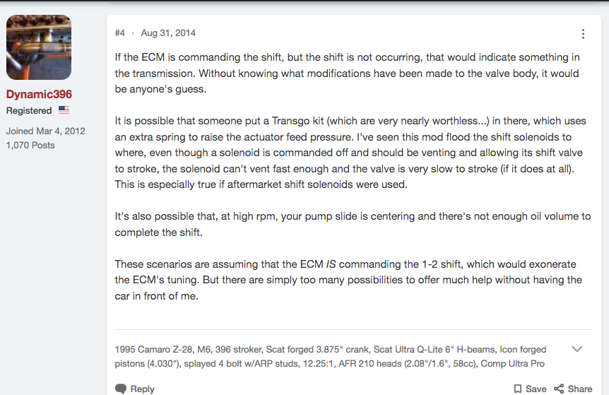

Ive played with the tune a lot.. and all shift settings happen spot on unless they are set above 6000 while I'm at WOT, which makes me doubt the tune (or VSS) as the problem. the screenshot below had some good sounding suggestions but neither seemed to be the problem (set max line pressure lower in 10psi increments 90-40 to test solenoid vent issue)
