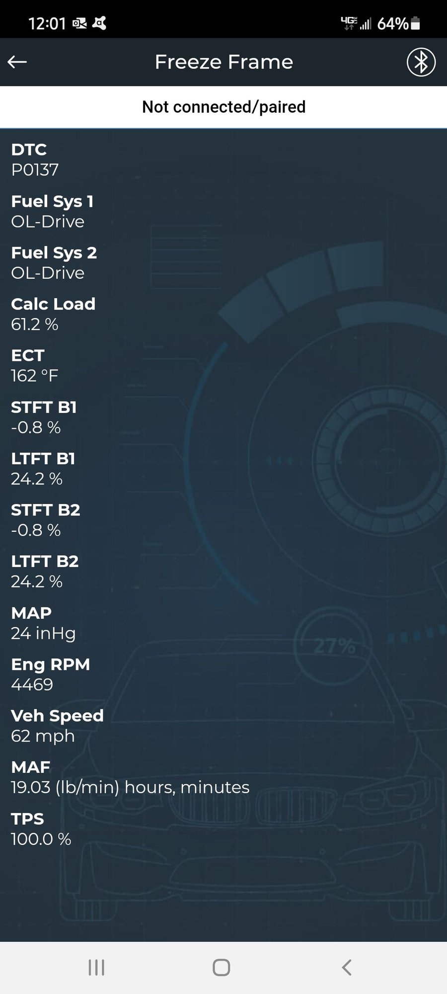

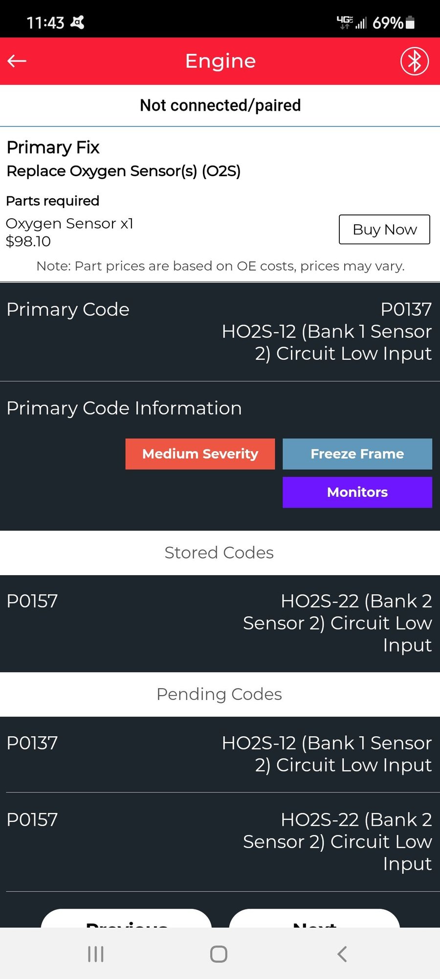

New to this forum and to ls1 4gens. Just bought a 99 ta w/ ls1 130k miles Auto. It's running like crap so far I cleaned the maf sensor didn't look dirty but cleaned it anyway. But still throwing code p0157 & p0137 bank 1 sensor 2, bank 2 sensor 2 which is i think 02 sensors after the cats. I've read through the post on similar problems but couldn't find nothing close to my issues.
should I replace the rear 02 sensor? Here's a screen shot of the dtc's.
