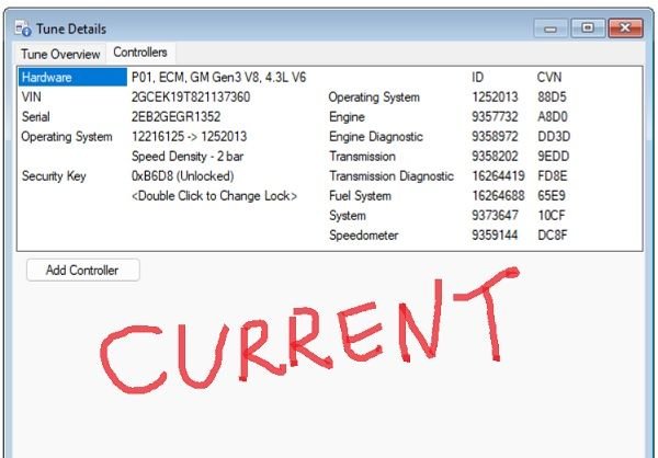

Car has been through multiple combos and currently runs a P01 2 BAR, FLEX FUEL enabled tune.

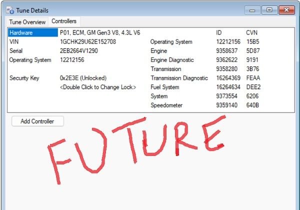

I have the current 2 BAR OS (still in car),
a STOCK 1 bar OS, and...

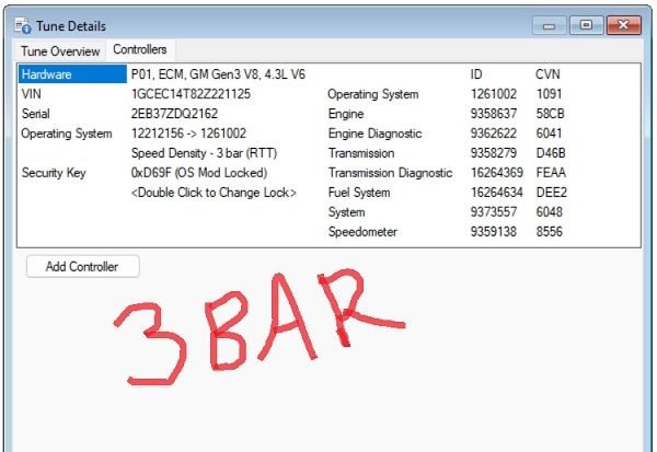

a 3 BAR OS (that WAS in the car a few years ago)
Note: ALL THREE have been used on this same car in the last few years

1. Can I simply WRITE ENTIRE the old (previous) 3 BAR OS that I ran a few years ago?

WRITE ENTIRE the 3 Bar tune and you'll be fine.
