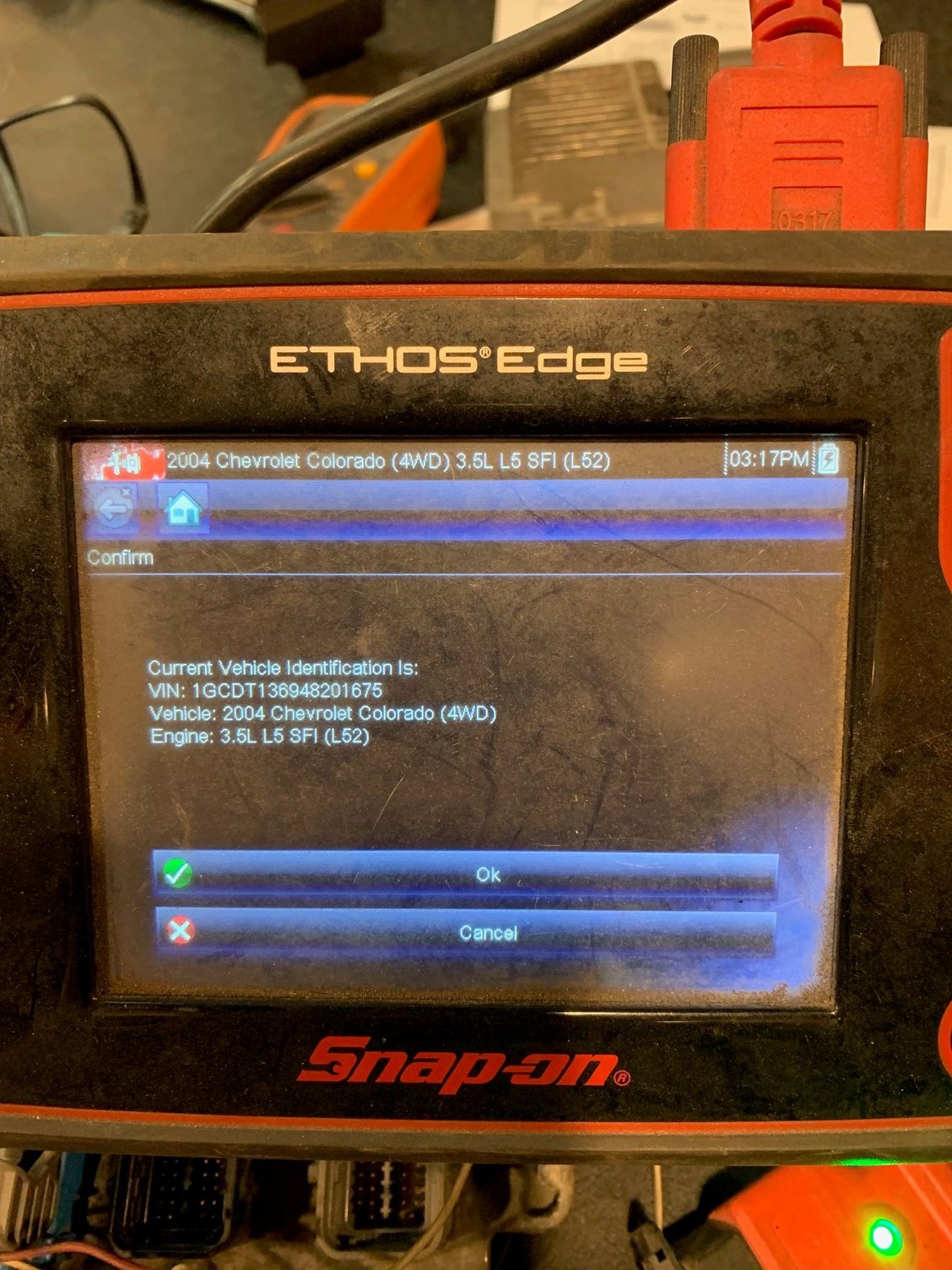

I had the the vin changed in the E40, but every time i try to get codes and data i can.t communicate with the ECM and wont pass inspection... I have Hp tuners, i have a passthru interface device just looking for the right direction to go.

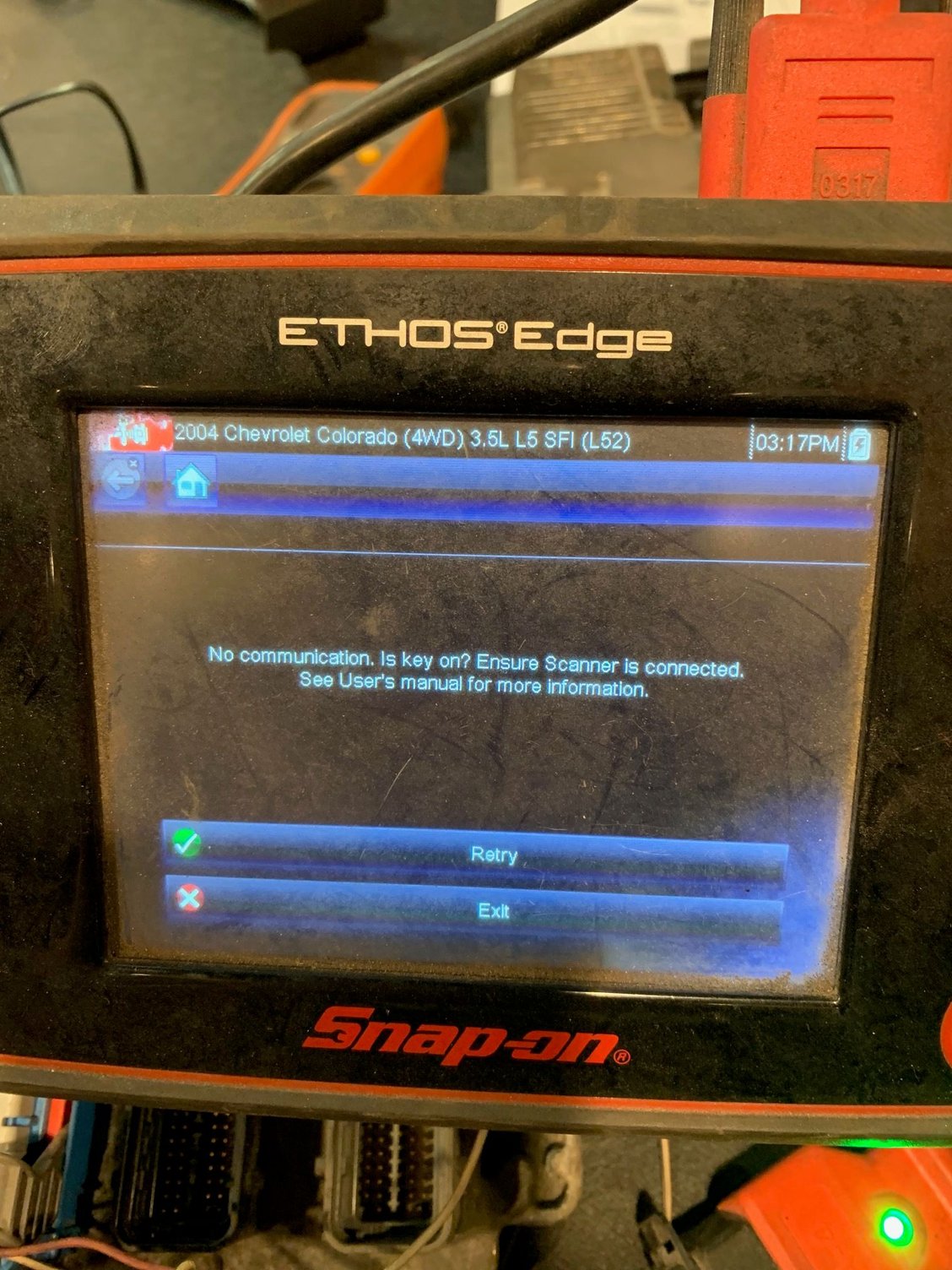

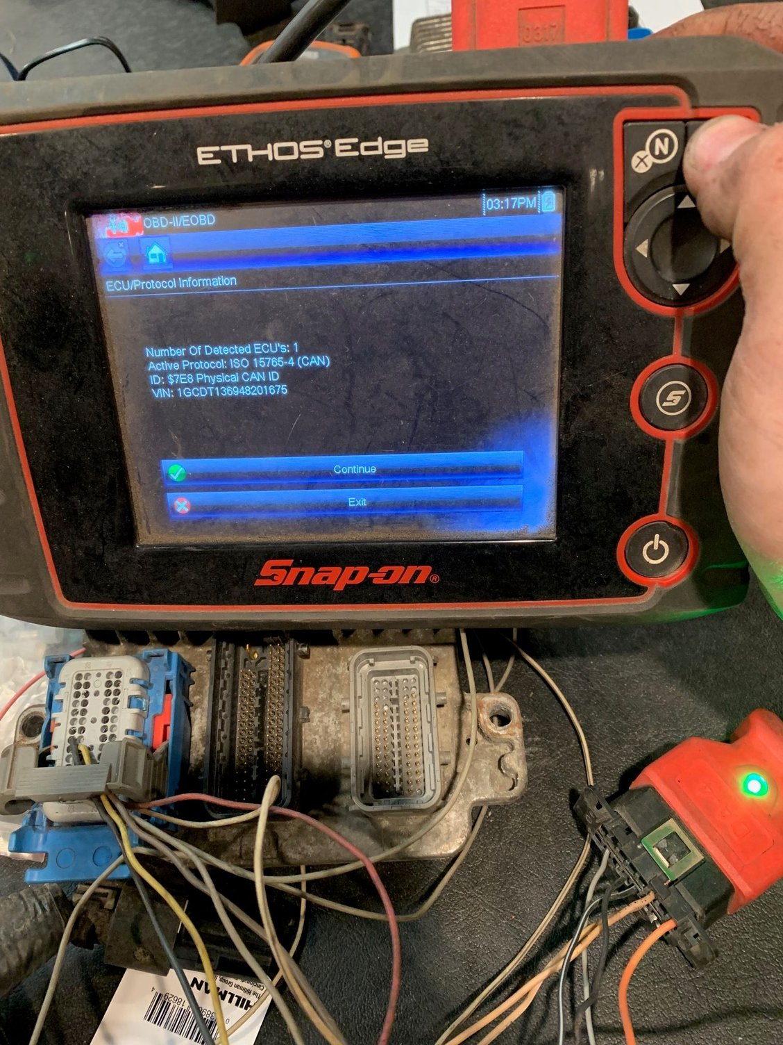

E40 with my truck VIN no communication with ecm or tcm

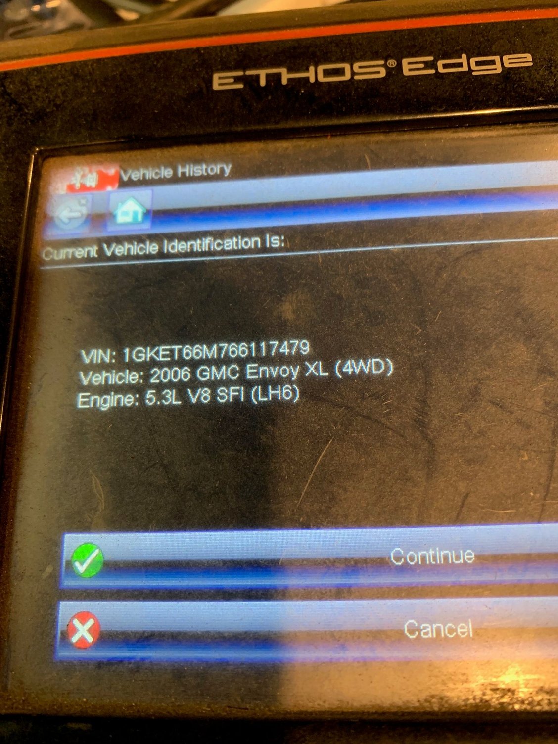

This is the donor vehicle will communicate

Been down that road, paid to get all the correct wiring. Wired up a bench harness exactly the same as the truck pinouts with can-bus and even communicates with the original P12 PCM. I'm going with software. It connects with the GMC scans for DTCs and shows live data, will not with the truck VIN selection.
